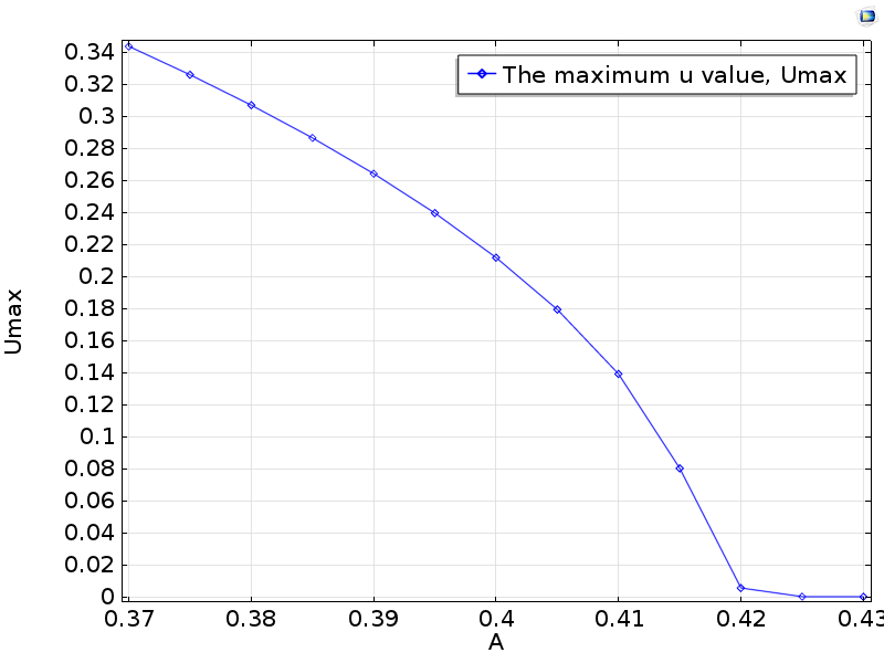

This can be checked by
(i) making the Parametric Sweep with respect to the parameter A from 0.37 to 0.43 with a step 0.005,
(ii) evaluating the Surface Maximum, Umax, in the Derived Values and
(iii) plotting the maximum value of the obtained solution, Umax, against A.
Please find the plot Umax=Umax(A) attached as the file Umax.png.
From the table corresponding to this plot I can derive the value AcNum as the A value at which Umax becomes greater than 0.0001.

The outcome is counterintuitive: instead of coming closer to Ac from below, I find that AcNum goes to the value of about 0.422 that is higher than Ac. Any further mesh refinement does not help.
The best value deltaAc/Ac is about 5%.
