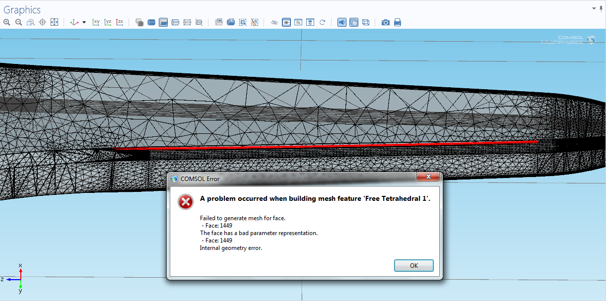

I try to insert a Geometry from an STL file in Comsol. Because the geometry is very small with rounding, I have set the "maximum boundary neighbor angle" to 1deg.
Unfortunately, if I want to create a mesh the following error appear:
A problem occurred when building mesh feature 'Free Tetrahedral 1'.
Failed to generate mesh for face.
- Face: 1449
The face has a bad parameter representation.
- Face: 1449
Internal geometry error.
How can I avoid this error?
Thx Thomas

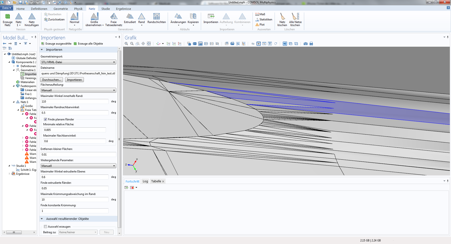

Dear Thomas,
there is no general fix, but it often helps to use virtual operations to combine the faces that are generated by the stl. Especially if you set the angle to a low value, you end up with a large amount of faces.
It is also very helpful to mesh the object in sections. Which means, first mesh the surfaces, then mesh some of the domains, until all are done.
Mesh settings that allow a large growth factor and small elements can also help in some cases.
I hope this helps you on your way.
Frank

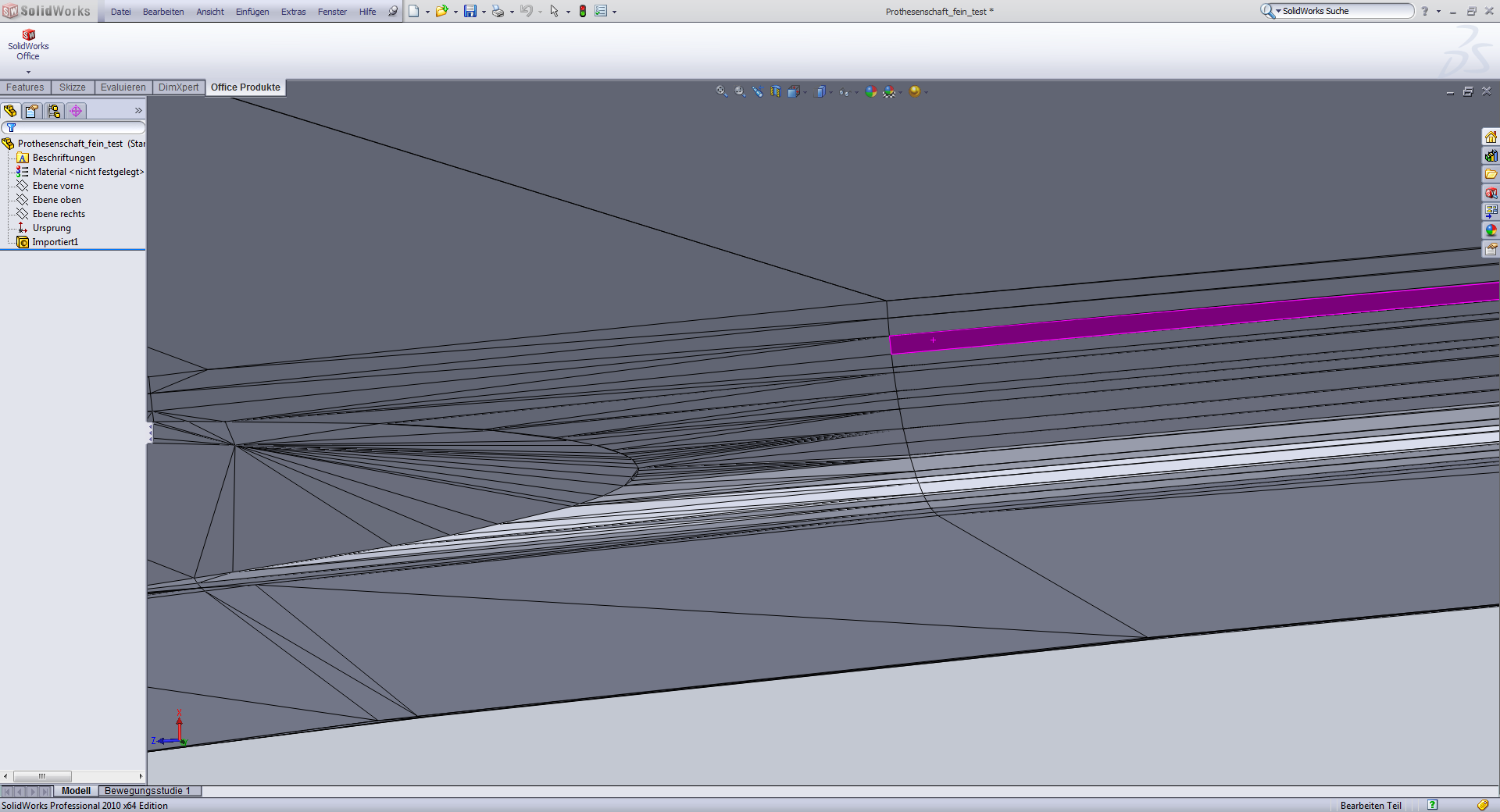

Dear Frank,
Thank you for your suggestions. Unfortunately I am not yet successful with many attempts.
I think the problem lies in the preparation of surfaces, I can open the STL file without any problems in SolidWorks 2010. And the surfaces in SolidWorks and COMSOL looks very different (shown in the screenshots).
Best regards, Thomas

Hi Thomas,
try to import not only .stl but also .x_t .dxf. You can save the geometry to different data type and import it to comsol.
anther tips, try to unchecked the comsol automatic repair. i think the problem with mesh started as you import the geometry. visualy control it after finalized. sometime to small tolerance cause problem, that comsol 'see to much than it should'.
there are alot more way to get import geometry done properly, above was the easiest thing you can try.
good luck
regards
akmal
