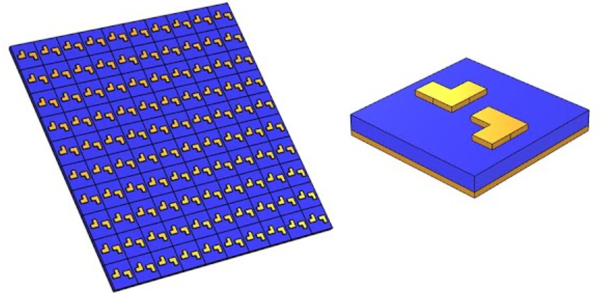

Thank you for writing. I want to see if there is a way to visualize light rays interacting with a unit cell containing microfeatures. Or if it is possible, how to measure how much light is scattered from normal incidence after interacting with the geometry. An example geometry is shown in the attached image (source: https://www.youtube.com/watch?v=Wj1v-9-Ak_8).
>What do you want to calculate exactly? In an infinitely periodic structure like the one you described the reflected angle is always emposed by your port boundary conditions. If you want to simulate the scattering off of a larger structure in multiple directions you need to simulate a larger structure. or at least a floquet port that supports multiple modes. Thank you for writing. I want to see if there is a way to visualize light rays interacting with a unit cell containing microfeatures. Or if it is possible, how to measure how much light is scattered from normal incidence after interacting with the geometry. An example geometry is shown in the attached image (source: https://www.youtube.com/watch?v=Wj1v-9-Ak_8).
One you have microstructures you can't really speak of light rays. I am still not sure what you mean by 'how much light scatteres from normal incidence'. If the structure is sub-wavelength all you will get is a reflection and transmission coefficient. There are plenty of tutorial that calculate this so I don't think this is what you mean. The reflection coefficient of a conducting structure will be 1 with some phase shift.
if you mean scattering in different directions you have to expose a larger area. You have to possibly include the diffraction orders or expose it with a gaussian beam or ambient field and calculate the far field pattern.
