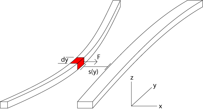

So my problem is, how can I specify this force in Comsol? Or specifically, how can I find the expression for point-by-point distance so I can use that expression in my force formula. I guess I can define like 100 pairs of points along the two beams and specify the force on each point manually, but I believe there should be an easier way to do this. Maybe something to do with pairs but I don't know.

before discusssing "how to in Comsol" you should perhaps think more over your model. Are you attempting a simple physics approach and want to add spme specific force functions yourself, or are you thinking of doing a "multiphysics" simulation, where the force is driven anoher "physics" than the structural ones (i.e. electrostatic, magnetic ...) ?
And second question, I find it difficult to believe you force i only due to the nearest point between the two bars, isnt it rather that for all dy the force is the integration of normal force component over the full length of the other beam ? (use the integration coupling variables)

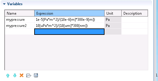

Variables versus parameters (constants):
I prefer to use Global Definition Parameters for any value that is "constant" therefore I would have defined "mypressure" as a Parameter, another advantage is that you get its value displayed too
Units:
Comsol is giving us (almost) everywhere tte units calculations, I find this very handy to check my values, as we work at so many scales that counting the "0" or the "E-nn" is easily erro-rprone. COMSOL flags unit inconcistencies by setting the equations (or eqution set for vector input) in orange, while red is for syntax typing errors, missing )] or whatever.
Now Comsol cannot always understand what we want so it might end up with funny units requeirng some handcalculation to check if correct. You can help COMSOL to choose your units by slightly modifying the one we use, such as for "mypressure" see image:
1[N]/(1[m]*2[m]) => 0.5[N*m/m^3]
while
1[Pa*m^2]/(1[m]*2[m]) => 0.5[Pa]
Then when using the / division operator with values & units, use enough brackets () as the units tend to be forgotten and the result is not always as expected (was required in V3.5, somewhat less important in V4)

Well I have played around, the best way I see is to use a global projection variable, this is a) because your surfaces are well aligned with the global coordinate system x,y,z, b) because I have trouble remebering correctly the vertex order for the linear projections ;)
So I define a general projection variable by integrating over "z" and dividing by the beam height, hence I get the average value, that I project onto each vertical line on the destination. I then define a surface load on the second beam. To see the deflection I must normalise it and I use among other the maximum deflection of the first beam to try to get the same "v" on both (this is rather mesh dependent as the integrations are taken over the mesh so I'm using already a quite fine mesh, still it should run within <2GbRam).
You get a certain number of warnings, havent looked into these, but I suspect its because of the overconstrained beams, at von Mises > 3GPa I'm not sure you Si would survive it this stress level ;) but that's another story
I learned too that I could not use a mapped/swept mesh, the general projection integration seem to dislike these !?
Finaly the web site java does not allow me to upload the model, as I have already uploaded a file and I'm editing my previous thread (?) so pls see next reply
It does not look like the most elegant way, and still I do not understand the underlaying physics that could act like this only on the distance between the beams and not on a projection of a global source surface integration
