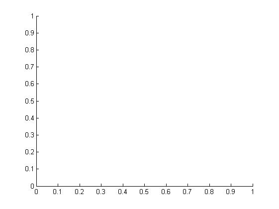

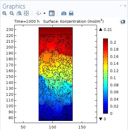

Thanks for your comment.
I have saved the mph file and then I wrote command in Matlab script. But it does not show the plot rather it shows error and a blank graph (Please see attachment: Matlab_figure). But the actual plot of comsol looks like the attachment 'Comsol_figure'.
The errors are given below:
Error using strcmp
Too many input arguments
Error in mphplot/1_getPT (line 485 )
Error in mphplot/geomedgeplot (line 289)
Error in mphplot (line 223)
I used only mphplot(model, 'pg1') command. I just want to render the plot to Matlab. Do you have any suggestion why I have this kind of errors ? Thanks in advance.

This is a bug that has been fixed in our latest update, which you can get here:
www.comsol.com/product-update/5.1
