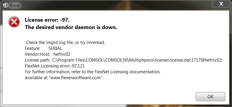

I've juste installed comsol with a floating licence and it's impossible to start the software.
Everytime I try to start comsol, I have a "licence error: -97" (printscreen of the full error attached to this message).
During the installation, I haven't had any problem regarding the licence server. I checked the message and the problem is simple. The licence manager of comsol wants to connect to an other licence server.
My file license.dat point out a local server "1719@hefruv02" and COMSOL wants to take the licence from the server "1717@hefrlic02" which is a licence server for an other software. How can I correct this problem?
