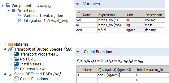

Gilbert,
Did not check it by myself but you might try the following:
1. Define integration operator over the volume where you want impose constraint on density.
2. Use this integration operator to define variables “vol”, “m”, and “den”.
3. Add Global ODES and DAEs interface.
4. In Global Equations node, define variable name “u” and set equation f=den-8[kg/m^3]. This will impose constraint on density in volume.
Image for the above steps is attached.
Gilbert, Did not check it by myself but you might try the following: 1. Define integration operator over the volume where you want impose constraint on density. 2. Use this integration operator to define variables “vol”, “m”, and “den”. 3. Add Global ODES and DAEs interface. 4. In Global Equations node, define variable name “u” and set equation f=den-8[kg/m^3]. This will impose constraint on density in volume. Image for the above steps is attached.

Thanks so much for your detailed reply! I will look into on monday right away. Any change you could add the model you made, so I can check how you set up everything?
