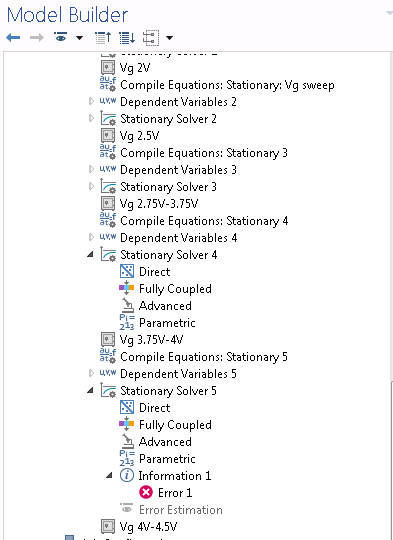

The capture image shows how I setup my study: For each study step there are four nodes:
1. Compile Equations
2. Dependent Variable
3. Stationary Solver
4. Store Solutions
And each study step corresponds to a parametric sweep. The last sweep I am running the voltage sweep from 4V to 4.5V and the computation screwed up at 4.4 V
Now all the solutions can be used between 4V to 4.3V, except they are stored in "Study2/Vg sweep solver" node, not in "Study2/Vg 4V-4.5V" node. The first one I can do post processing but because it is a dynamic solution node, I can't use the 4.3V solution as the initial condition to solve for further parametric sweep after 4.5V. It would overwrite this solution node and, everything will be screwed.
