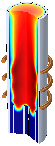

This file is real and right picture of icp torhes.
Could you describe the main settings in this model (attach file from highlights Comsol 5.0)? This file is real and right picture of icp torhes.
