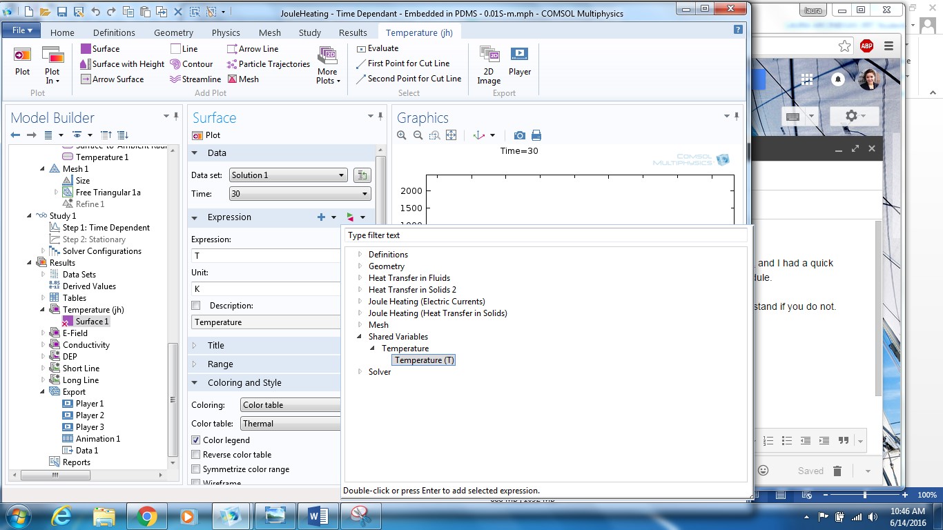

Older versions of COMSOL had a shared variable: T for Temperature.
As seen here:
Inline image 1
New versions do not have the "T" dependent variable.

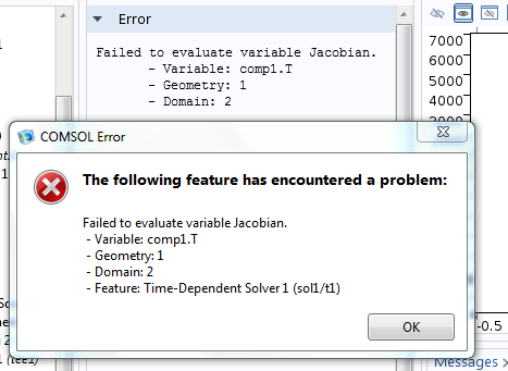

That is why when I try to use it I get this error message: Inline image 2
I have tried to assign and initial value for T under the global parameters so that it can get overridden by other heating sources later but I am still receiving the same error.
How can I create a dependent variable for Temperature in COMSOL 4.4?
Thank you for your time !
