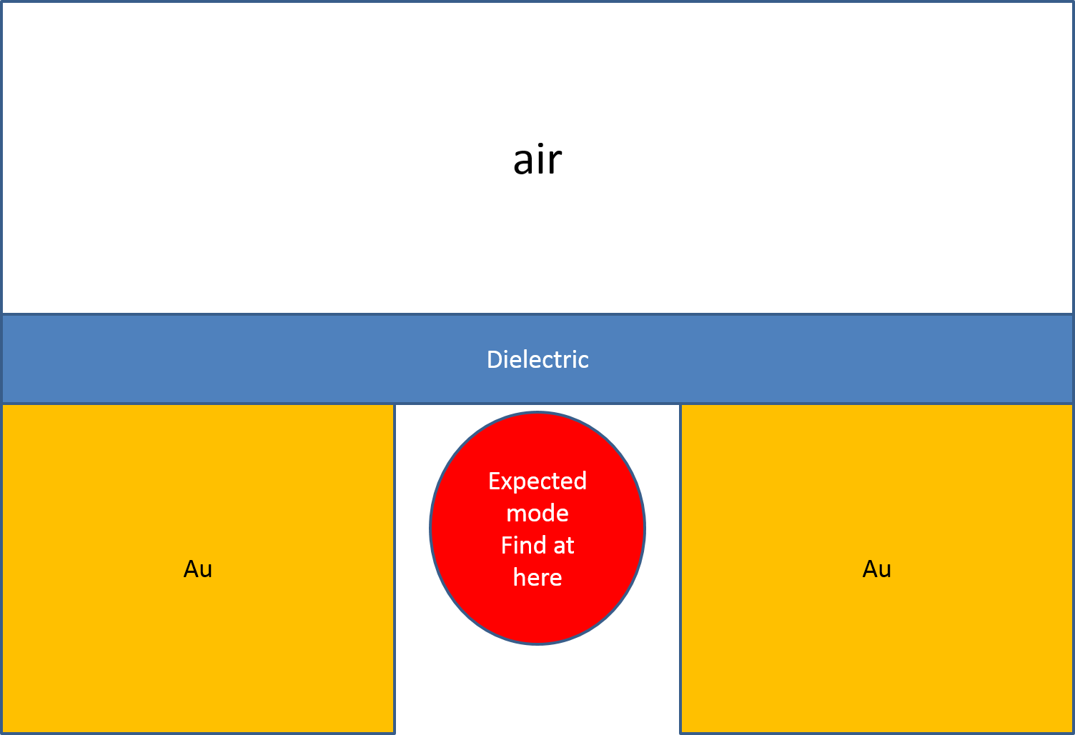

                                                    Hi Sergei,
     Thank you very much for you time and effort, it is helpful!

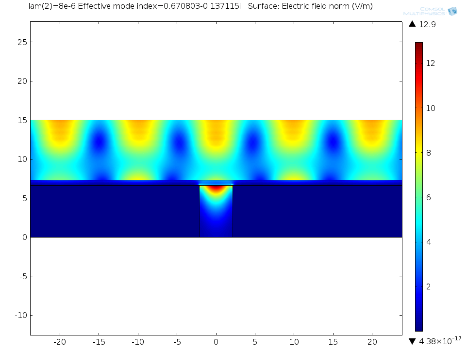

     For the periodic BC, I suppose to use the "continuity" type right? But I looked after the previous post about periodic BC, it said that the continuity is somehow similar with PEC, why is that? and I know for my case I shouldn't use the floquet periodic because i can't define the kx vector.
     I tried the periodic BC, and find the mode that I wanted, however, the mode kinda of spread out in the entire simulation area. I have attached the png file, you can see that there are some field distribution outside my waveguide. I am wondering how these parts will affect the effective index? Will they increase the imaginary part of the effective index?
