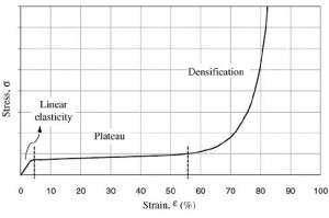

I'm trying to implement Ogden's model for polyurethane elastic foams into COMSOL. Currently, I'm working with the structural mechanics module and trying to model the uniaxial compression stress-strain response of these foams. The tend to behave in a non-linear fashion and a typical stress-strain curve is attached herewith. As I'm new to COMSOL, can anyone suggest how to change the governing equations and boundary conditions and preferably some tutorial on the equation modification process.

Thanks for your efforts in replying. Yeah I will try to work in the way as you suggested. Actually, my material in not anisotrpic, but it behaves non-linear in any direction of load invariably.
