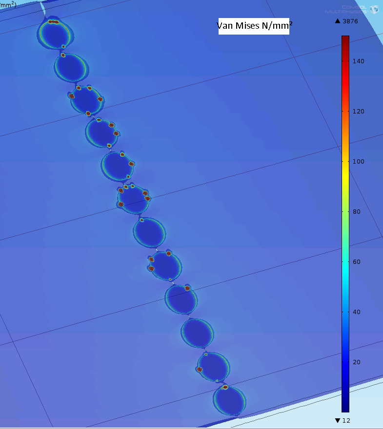

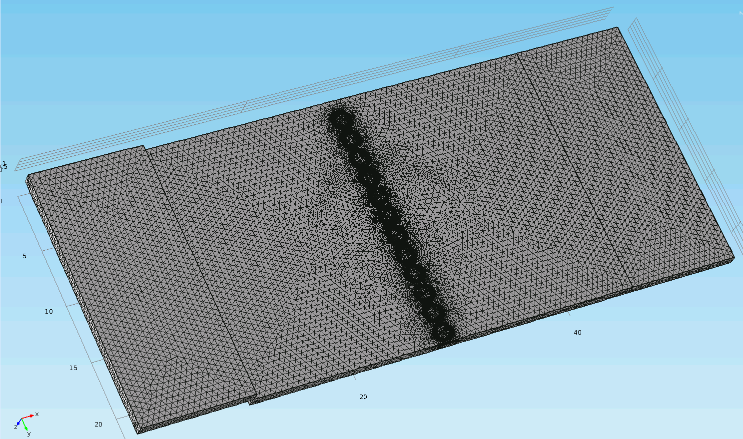

Problem was solved by the comsol support. The meshes on the two sides didn't match each other, which caused these unplausible results.

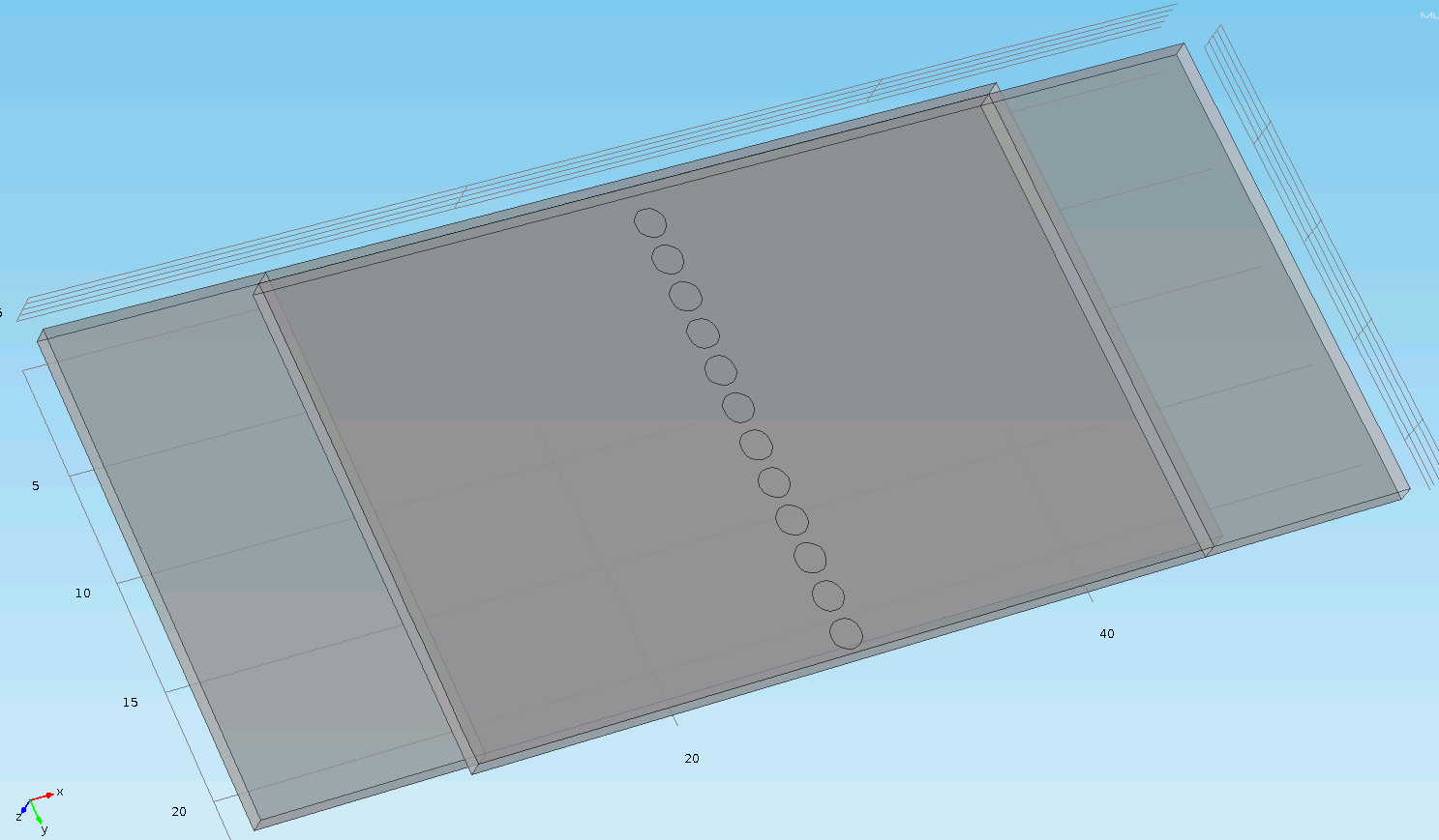

In attachement 1 you can see the geometry of the model, which consists of two plates (aluminium) that are only connected in the circular areas.

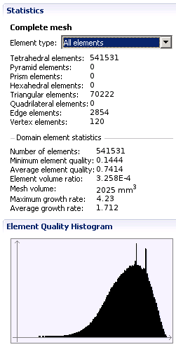

In attachement 2+3 the mesh and the mesh statistics are shown, which are quite ok. A finer mesh is not possible, because of limitations in computational power. The mesh is a free tetrahedral mesh for the whole geometry.

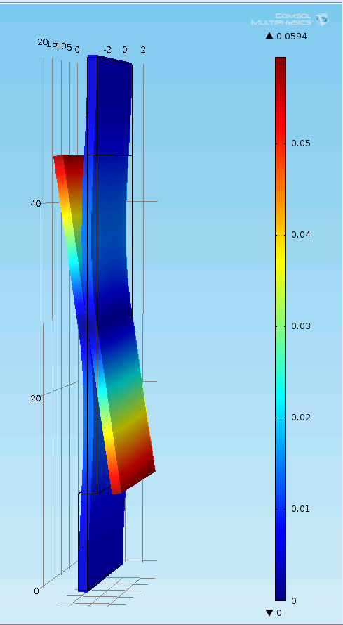

The deformation plot (Attachement 4) looks plausible. The stress plot (Attachement 5) shows circular stress distributions araound every contact area, which is also plausible, but it also shows very high, randomly distributed maxima around the contact areas which is not plausible for me.
Are there any ideas how to solve this problem? It seems to be a problem with the mesh, but it happened with different mesh sizes and parameters too.
