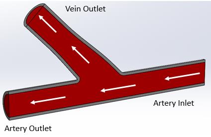

I am doing a 3D FSI model on a simple branched artery with blood flow. I naturally want the artery to expand and contract as the fluid moves though. What is the best way to constrain the inlets / outlets? Rollers do not add enough constraint and fixed edges constrict the artery from expanding / contracting. In addition, I get high stresses at the areas of constraint.
Attached is a picture of the geometry where the arrows are the fluid flow

Attached is the picture of the geometry.

Hi Barrett,
One way to define constraints that prevent rigid body motions without causing localized stresses, and without preventing contraction/expansion, is to define displacement constraints on each end of the artery in a “distributed” sense. Conceptually you would fix the average X, Y and/or Z displacement of a boundary to be zero instead of fixing a specific point or the whole boundary.
You can do that by defining a Component Coupling operator, type Average then using it in a Global Constraint. For example if your operator is aveop1() you can set a global constraint to “aveop1(u)” to set the average displacement of the boundary in the X direction to zero.
