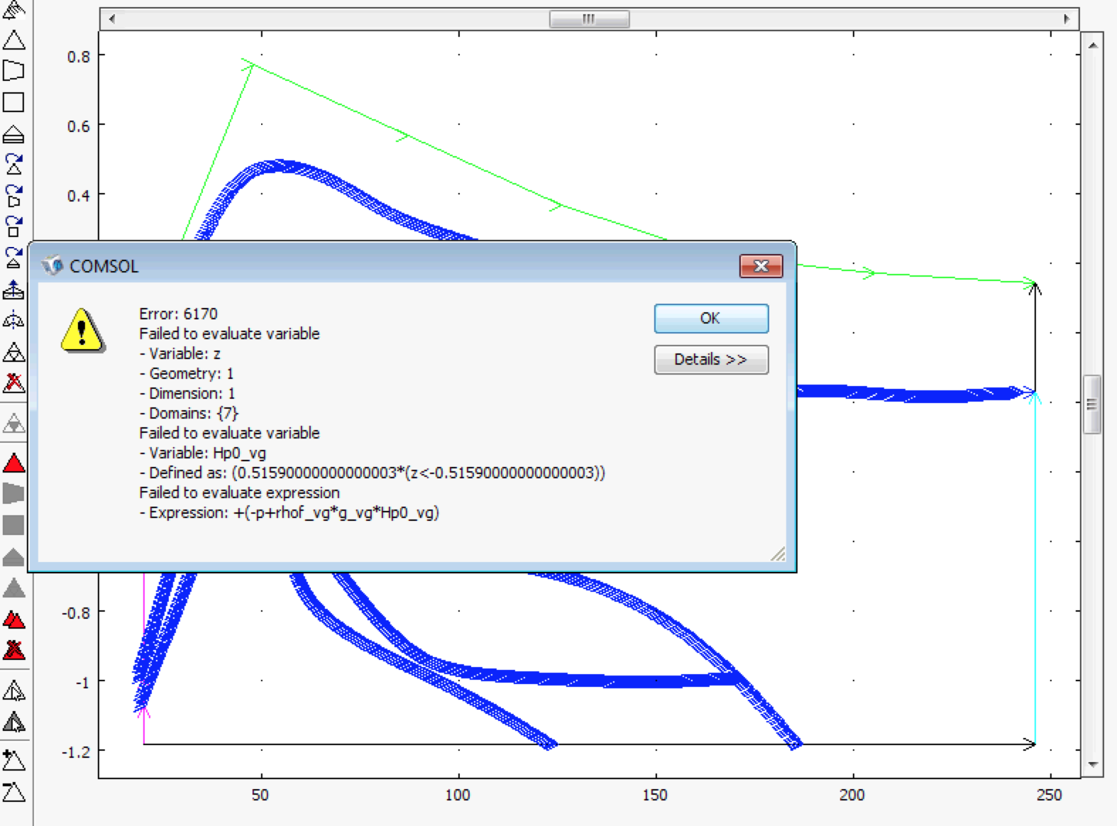

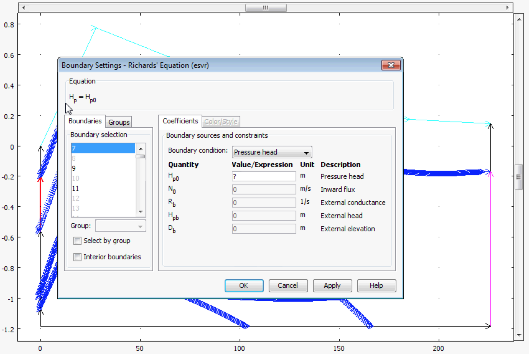

I want to define two conditions for one part of rectangular that I have in 2D (xz) and put two different value of pressure head in one boundary condition,
like Hp=0 if z>= - 0.5159m
and Hp=0.05159 if z< - 0.5159m
how is it possible to write these in one boundary condition?
Attached screen shot for better explanation

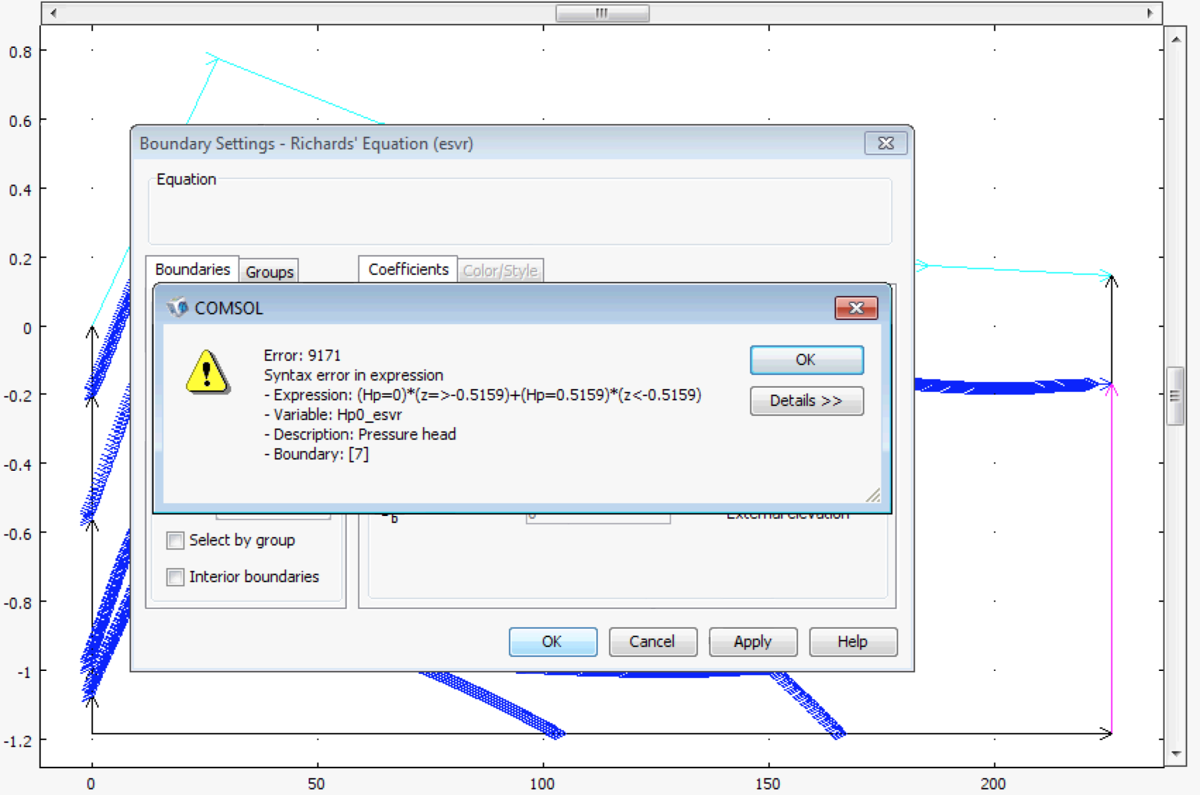

I wrote expression in a way that I put the screenshot, But I confronted with this error,
I am new in comsol and I need your help.
Best
Sepideh

Use the following expression:
0*(z>=- 0.5159)+0.05159*(z<- 0.5159)
or simpler just
Magnus Ringh, COMSOL
Hi, Use the following expression: 0*(z>=- 0.5159)+0.05159*(z
Posted: 1 decade ago 19 mar 2014, 13:59 CET
or simpler just

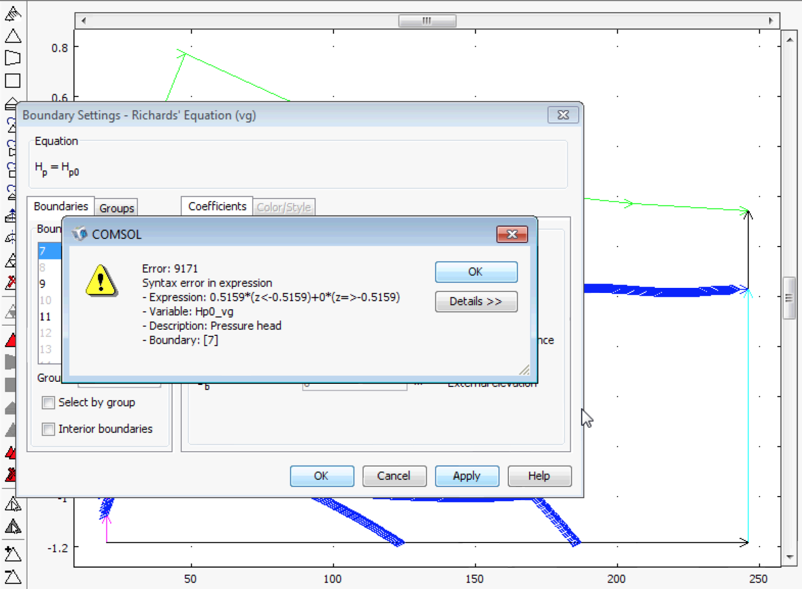

Thanks for reply Magnus,
I tried with the first expression and I confronted with error in screen shot1, and then I tried with the second expression and I confronted with screen shot2.
I am new to comsol, therefore your comments will help me a lot.
Sepideh

Could it be that none of your spatial coordinates is called z? Typically, in a 2D model, the spatial coordinate names are x and y.
Hi again, Could it be that none of your spatial coordinates is called z? Typically, in a 2D model, the spatial coordinate names are x and y. Best regards, Magnus Ringh, COMSOL
Posted: 1 decade ago 20 mar 2014, 16:39 CET
Thanks a lot it worked with "y", and I just defined one side of rectangle for two types of condition like this
(C1*(p<p1) + C2*(p>=p1)). C1 and C2 are conditions.
Hope it helps for others.
Sepideh
