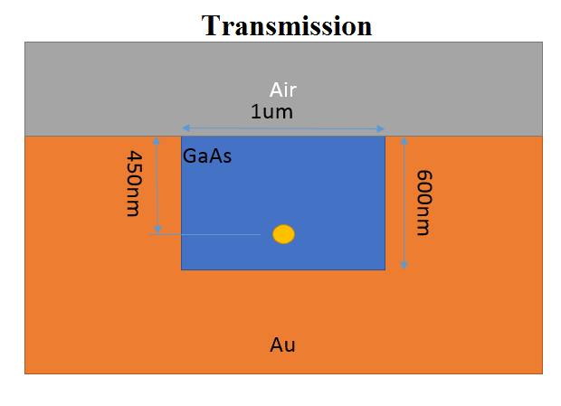

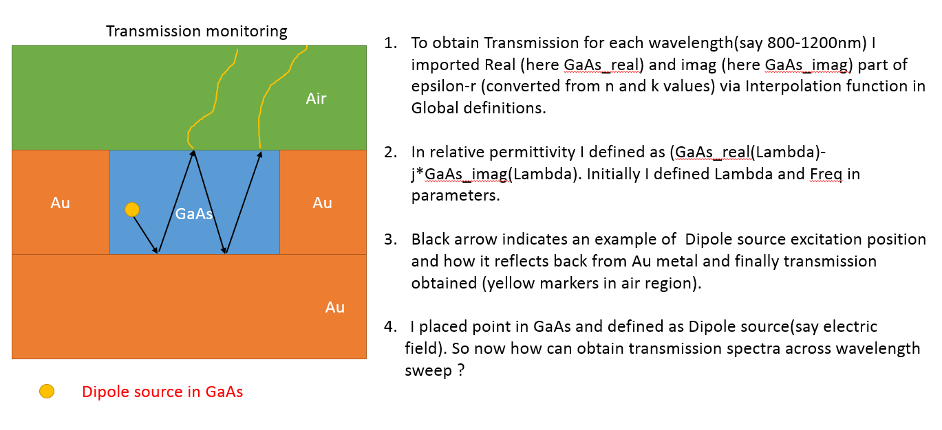

I had attached the concept of my simulation as picture where you can understand my idea.
For obtaining Wavelength vs Transmission spectra I need to include all Refractive index (n and K values of GaAs). I had imported Refractive index values via interpolation. I had converted n and k values to Relative permitivity say GaAs_real and GaAs_imag.
Previously in Parameters I had defined Lambda = 1000 and frequency = c_const/Lambda[nm]. I had used nm in Lambda since imported (ex. GaAs_real) wavelength values as say 800 ..... without nm.
In GaAs Material properties I had defined Relative permittivity as = GaAs_real(Lambda)-j*GaAs_imag(Lambda). I think this is correct definition.
So In Parametric sweep now I can do Lambda dependent.
My Goal is to get PL spectra ( Transmission ) vs wavelength. I had placed Point in GaAs and used that as Dipole source. My target is to achieve Transmission spectra coming out from GaAs vs wavelength (say 800-1200nm). I m really confused here how-to-do. For obtaining transmission spectra do I need to use port condition or what ?

For obtaining transmission(hereafter T or PL) spectra, i think we can adjust the height of transmission monitor to get the best from GaAs top surface.
Coming to your 2nd point - //How do you determine the baseline "incident" power from a point dipole inside a small structure (i.e. in the near field)?// I couldn't understand this ? Why we have to determine the baseline incident power ?
I understood that you used Boundary probes for obtaining T. In Relative permittivity it should be square of refractive index right ?
And in Dipole, you had chosen Dipole moment . How about choosing Magnitude and direction and is it possible for getting T??

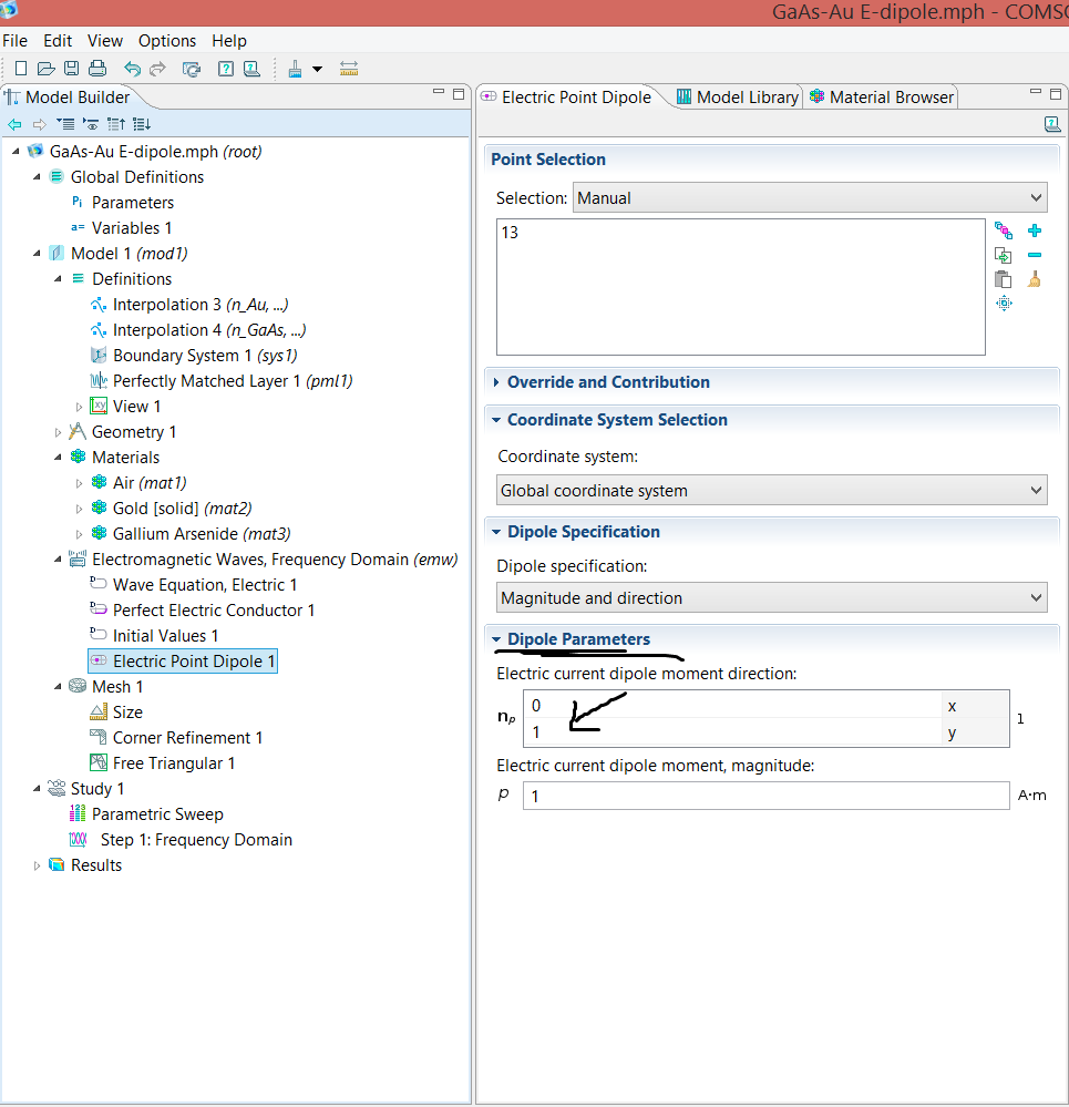

I want to simulate the Vertical and Horizontal polarization of dipole source. May be better I can post this as new topic of discussion which will be easier for us to discuss. I would be glad and thankful if you could help me.
Anyways I can give a description here too.
Its the same structure with electric dipole source. For this we need to import n and k values for both GaAs and Gold right ? I did it and imported via interpolation. Since I m dealing in Lambda I made arguments in nm. The data source file for GaAs and Au is attached below. I got that from refractive index.info site. I think for each wavelength, the values are not listed.So this would be fine for simulation?? And I had defined the relative permittivity in GaAs and Au. Can you check if thats right ?? Can we use Scat B.C or PML for this ?
For Vertical and Horizontal Polarization, I chose Dipole : Magnitude and direction. So in this x = 0 and y=1 for V-Pol and vice versa for H-Pol right ? Correct me if I m wrong.

Now, back to the dipole. Yes, you can control the polarization in the manner in which you state. You could even place multiple dipoles of various magnitudes and directions on top of each other to simulate coherent, unpolarized emission (I think there is a laborious way to do incoherent emission). However, the question remains as to what kind of data you would like to retrieve. You mention "finding electric field with Point source will be easy using COMSOL"--you are correct, it is! Just place the boundary/point probe where you want to sample (average, integrate, etc.) the field generated (and scattered) from the point source. But so what? Is the full-field output all the information you need? You will not get a transmittance that way! You won't even isolate the scattered field that way. So what is it you WANT to get out of the simulation?

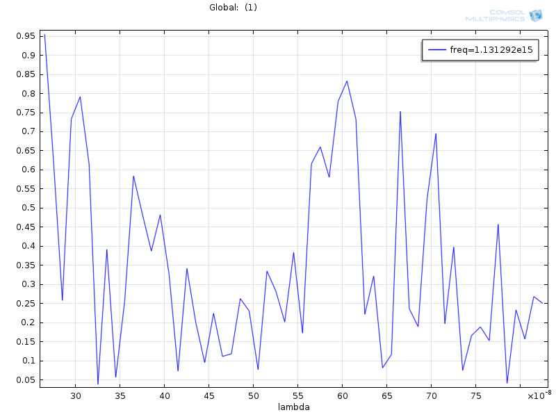

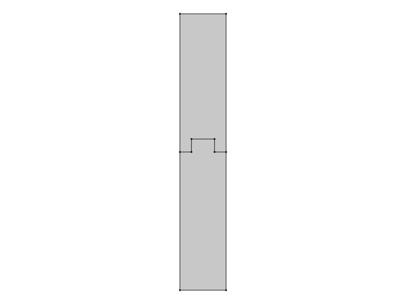

I am trying a similar simulation of transmission and reflection spectra vs wavelenght but in my case the input and and reflectance ports are the same and there is a transmission port on the other end. The base material is silicon and I have periodic structures on the surface (2D simulation). I am using version 4.4 and the RF module.
I have set up n and k interpolations for the wavelenght range of interest similar to the description above.
When I plot the reflectance I am getting a highly oscillatory result. Does anyone know why this might be happening? When I dont have any structures and keep the surface flat, I get the right reflectance values from literature.
More details on my problem are on this thread www.comsol.com/community/forums/general/thread/80041/#p184421
I have attached images of the results and the structure of interest.
Any help on this would be great. Thank you.
