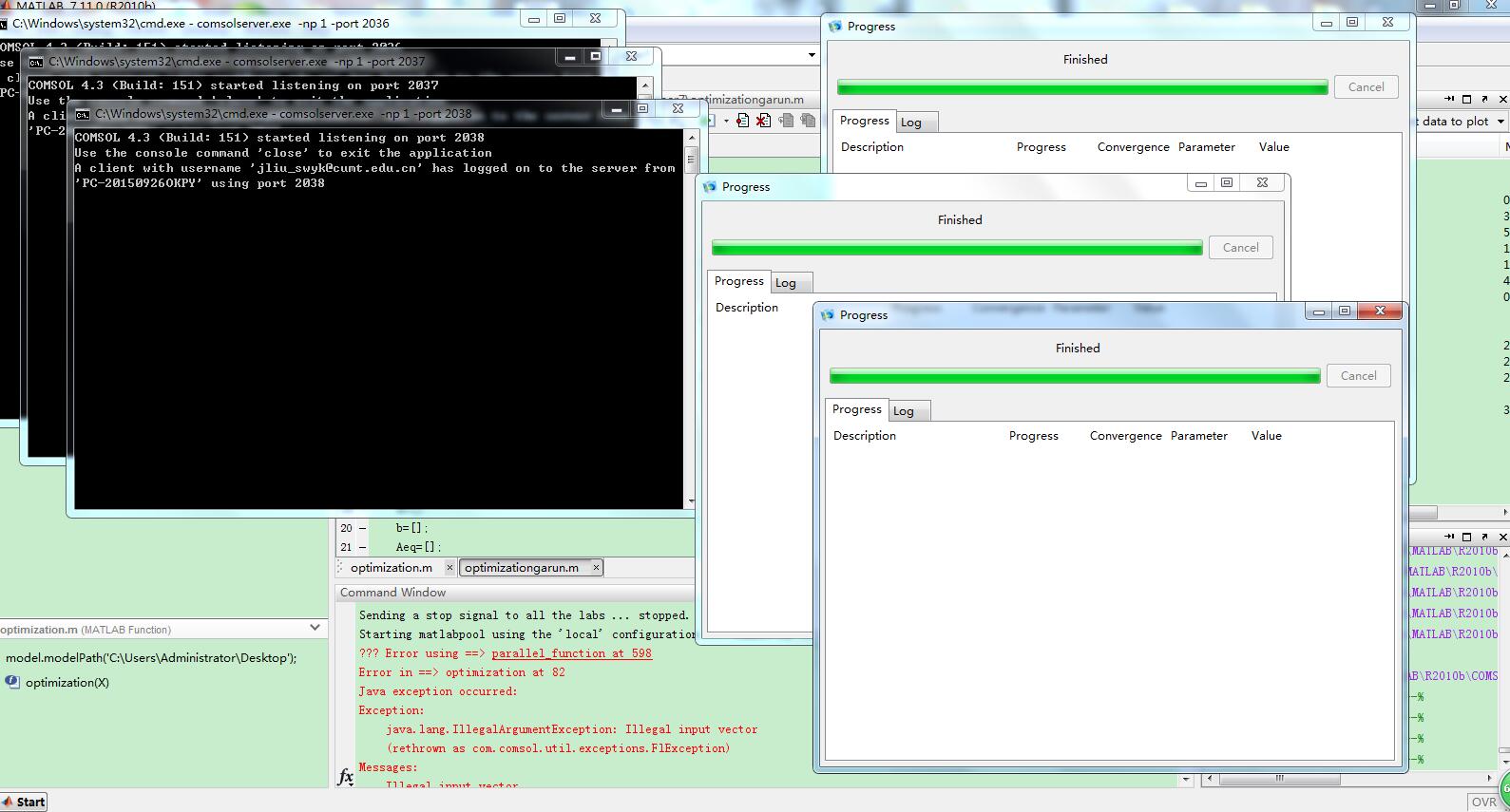

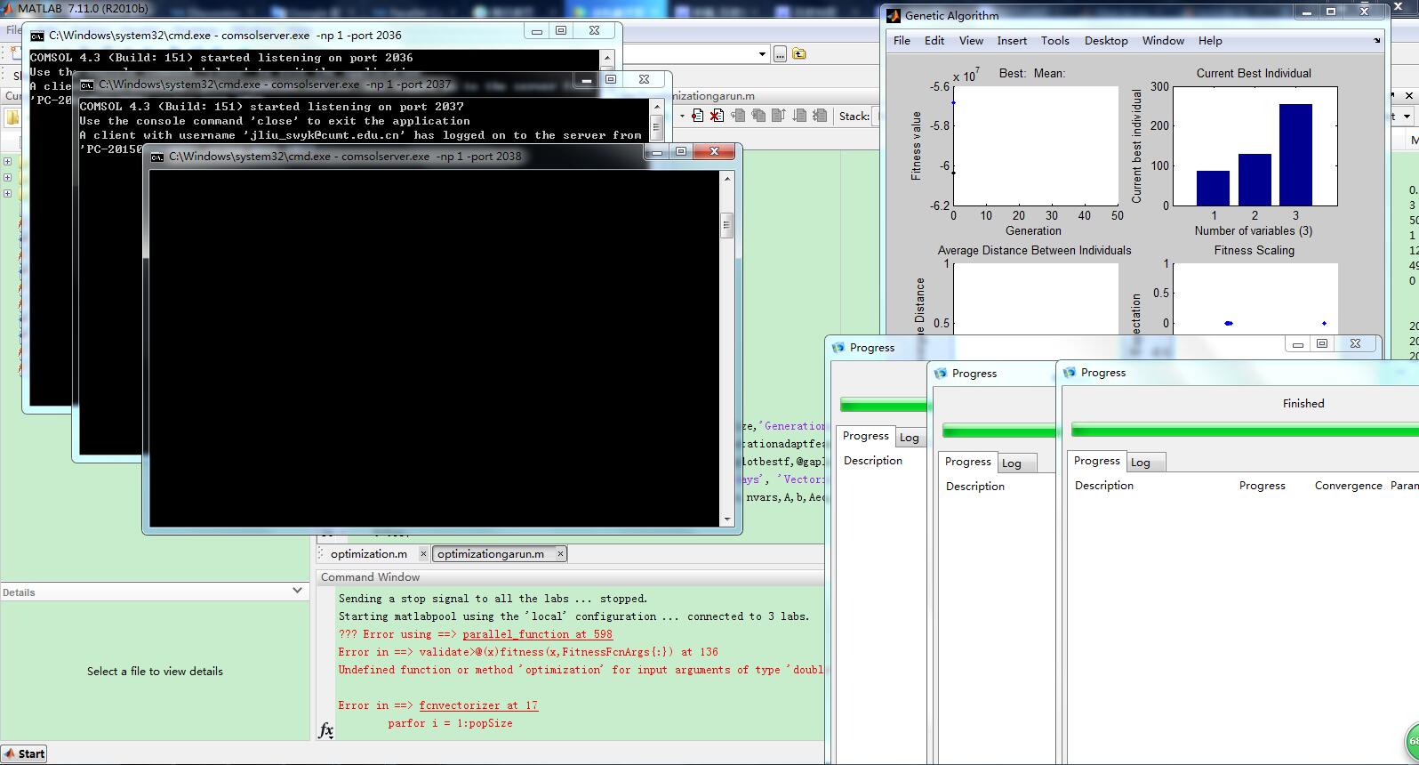

I am trying to use Matlab's Global Optimization tool (specifically using genetic algorithms) with my function based on comsol. According to a previous post (cn.comsol.com/community/forums/livelink-products/thread/38557), my optimization code is very unstable and occurs two kinds of errors (see Attach File). Calling upon multiple comsol server simultaneously in Paraller Computing is a key here. Can you help me?(comsol 4.3 and matlab 2010b)

Your questions appear not to be directly related to this thread. I invite you to start a new thread.
To request technical support from COMSOL personnel, please email support@comsol.com .
