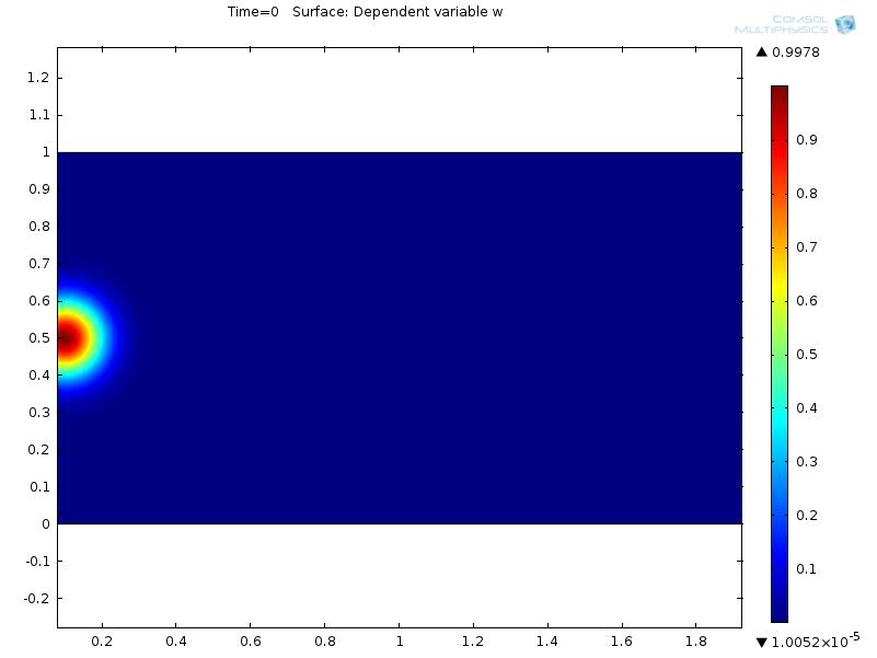

When I set the diffusion coefficient c = 3.6E-1 [m^2/s], I see the following:
At time = 0 ns, I get a nice round blob, as expected
(see file "2D_ConvDiff_ExtrFineMesh_Circle_h0_2mm_0ns.jpg")

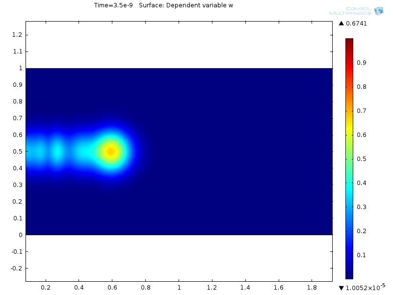

At time > 0 ns (for instance 3.5 ns and 7 ns), this blob moves to the right, slightly diffused in all directions
However, there seems to be a strange ripple in the tail after the blob...
(see file "2D_ConvDiff_ExtrFineMesh_Circle_h0_2mm_3p5ns.jpg")
So, my question is: why do I get these ripples?

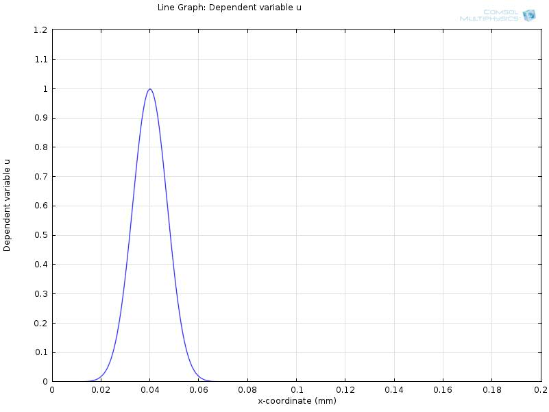

At time = 0 ns, I get a nice Gaussian shape
(see file "1D_DriftOnly_ExtrFineMesh_h0_0p2mm_0ns.jpg")

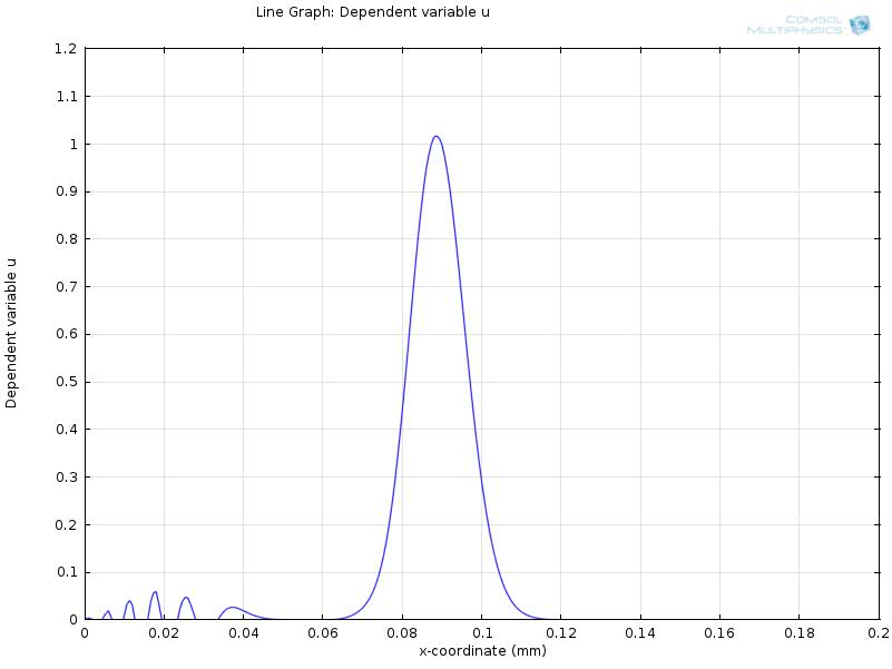

At time > 0 ns (for instance 3.5 ns and 7 ns), the curve moves to the right.
However, again, there appear strange ripples after the tail of the curve
(see file "1D_DriftOnly_ExtrFineMesh_h0_0p2mm_3p5ns.jpg")
So, my question is: why do I get these ripples again?
