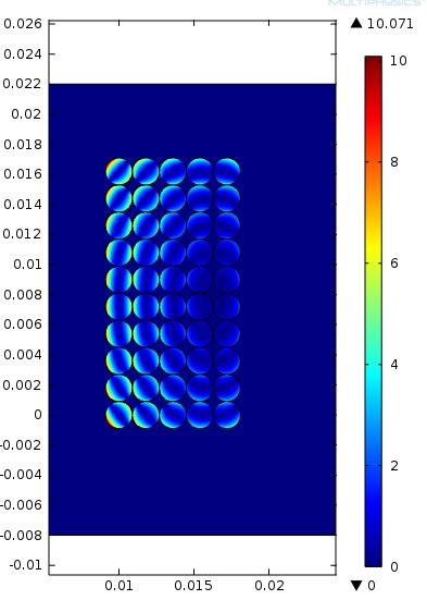

Hi, i'd like to know the relation between the quantities normJ and the components of the vector J (Jr, Jphi, Jz). I have simulated a coil group domain driven by a current of 10A.
The components Jr and Jz are equal to zero. So the vector J should be J=(0,Jphi,0)
A vector norm in 3D is defined as norm(v)=sqrt(v1^2+v2^2+v3^2), i.e. the square root of the sum of the norm of its components. In the above mentioned case, I would expect normJ and the Jphi component to have the same value, but it doesn't happen.
Unfortunately I cannot find any explanation of the relation of these current density quantities in the documentation set. If somebody could enlight my mind, this would be much appreciated.

Thanks for the reply, just two more questions:
1. which of the both expressions (normJ , Jphi) represent the real value of the current density. I think its normJ but i'm not sure.
2. If you look at the Jphi plot, there are positive and negative values. Although only the real part of the current is shown. Do the positive and negative signs mean that the current is flowing in opposite directions?
Thanks for the reply, just two more questions: 1. which of the both expressions (normJ , Jphi) represent the real value of the current density. I think its normJ but i'm not sure. 2. If you look at the Jphi plot, there are positive and negative values. Although only the real part of the current is shown. Do the positive and negative signs mean that the current is flowing in opposite directions?
Posted: 1 decade ago 1 lug 2013, 10:54 CEST
The norm is real and positive by its defintion, the Jphi component can be complex. And Jphi in your picture obviously goes in both directions, looks like eddy currents.
