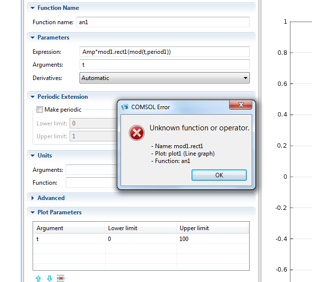

I have flow through a cylinder, and want the inlet velocity to be periodic [ u(r,t) ]. Im new to comsol and havent been able to find an answer to this.

I use the analytic function under definitions for that.
I needed a pulse and solve it with a rectangle (rect1) under definitions and an analytic function:
Analytic function name: an1
Expression: mod1.rect1(mod(t,period1))
argument: t
and fill in at your inlet velocity: "value" *an1(t[1/s])

One question, where do you define the "period1" variable?
I define it in the parameters under Global definitions, but you can also fill in the value of your period instead of periond1.
Barend
Ok, so I defined the parameters, Amp and period1 in the parameters menu. When I try to plot the an1, it gives me an error "unknown function or operator" mod1.rect1.
I attached a picture of the error if you want to take a look.
Thanks again for helping!
Hope that it will work now.
Barend
That you velocity have a particular value of t=1 till t=3 in a period and for the rest the inlet velocity is 0.
Or do you want a wavelike kind of inlet velocity?
That will make it perhaps easier to help you.
