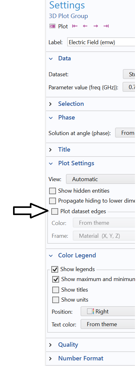

I want to hide some edges in the geometry for the visualization purposes to plot the contour plots.
In model builder in the definition section under the view option , there is option for 'hide for geometry' but there is no option for 'hide for physics'.
How can I enable this option for better contour plots in post processing without intermittent lines/edges ?

To hide edges in post-processing, consider unchecking the "Plot dataset edges" checkbox under Plot Settings in the Settings panel associated with your plot. For example, see the snapshot attached.

Thanks Robert for the reply, it works well.
