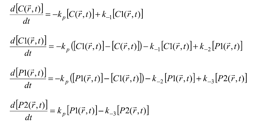

Posted: 1 decade ago 8 giu 2013, 03:26 CEST
Hi Jens,
His response was also important to me. However, I need to make functions that vary in position and in time (attached)! shall ye make help me please? Therefore tried to declare functions and also no success.
Thank you.
Jânio Anselmo.
Hi Jens, His response was also important to me. However, I need to make functions that vary in position and in time (attached)! shall ye make help me please? Therefore tried to declare functions and also no success. Thank you. Jânio Anselmo.
Magnus Ringh COMSOL Employee
Posted: 1 decade ago 10 giu 2013, 09:25 CEST
It seems that you should be able to use a Domain ODEs and DAEs user interface for specifying a "distributed ODE", where the right-hand side can depend on the spatial coordinates in the domain.
Magnus Ringh, COMSOL
Hi, It seems that you should be able to use a Domain ODEs and DAEs user interface for specifying a "distributed ODE", where the right-hand side can depend on the spatial coordinates in the domain. Best regards, Magnus Ringh, COMSOL
Jânio Anselmo Engenharia Biomédica
Posted: 1 decade ago 16 giu 2013, 00:50 CEST
Hi Mr. Magnus.
Firstly thanks for your reply! I'll be performing your second statement! Warning on new questions!
Thank you.
Jânio Anselmo
