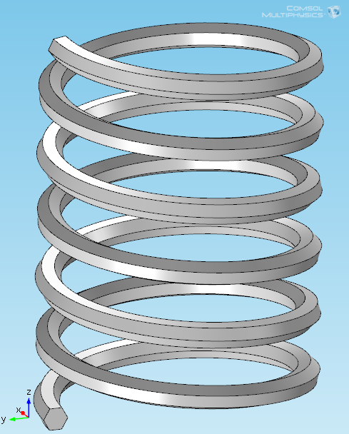

Shijie,
Use Parametric Curve and Sweep options to create helix of arbitrary cross-section. Example is shown in the attached file.
Sergei
Shijie, Use Parametric Curve and Sweep options to create helix of arbitrary cross-section. Example is shown in the attached file. Regards, Sergei

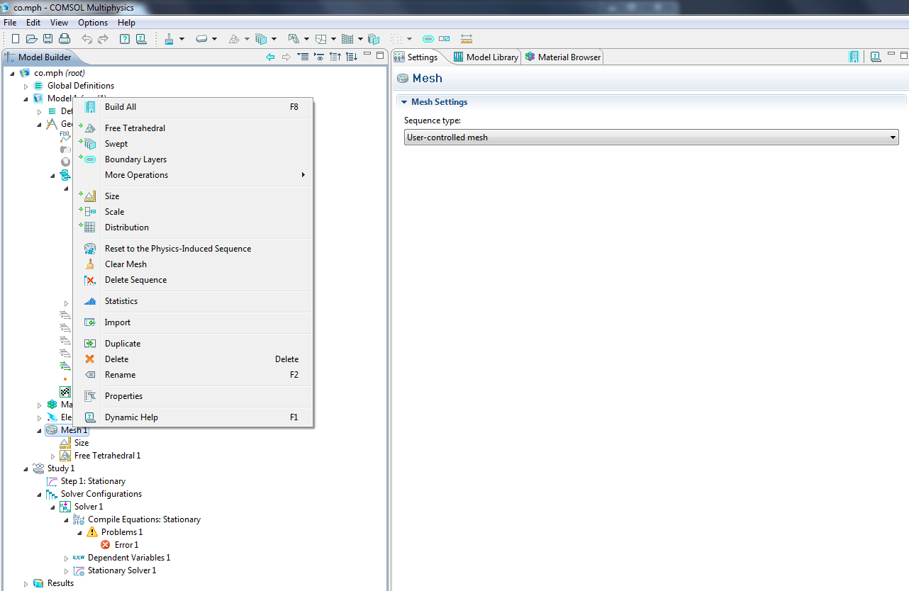

Posted: 1 decade ago 22 feb 2013, 05:43 CET
Thanks Ivar
But I didn't see "dimension" sub tab on the mesh node(see attachment)... Or is it possible to use a for-loop directly in comsol?
If I wanna decrease the cross section along sweep direction, should I use "motion of cross section"? and how do I set scale factor? (I set parameter name as 's' and any scale factor with s will give me an error "cannot find a valid topology for the generated geometry object"/"internal geometry error")
Cheers
Thanks Ivar But I didn't see "dimension" sub tab on the mesh node(see attachment)... Or is it possible to use a for-loop directly in comsol? If I wanna decrease the cross section along sweep direction, should I use "motion of cross section"? and how do I set scale factor? (I set parameter name as 's' and any scale factor with s will give me an error "cannot find a valid topology for the generated geometry object"/"internal geometry error") Cheers
Posted: 1 decade ago 22 feb 2013, 07:45 CET
sorry my fault it's "Distribution",
read the doc about the mesh nodes, its important to understand in which order you call them and the difference of a major node and a sub node, performing a few of the model library examples helps too, at least those (or the video) about the meshing
Hi sorry my fault it's "Distribution", read the doc about the mesh nodes, its important to understand in which order you call them and the difference of a major node and a sub node, performing a few of the model library examples helps too, at least those (or the video) about the meshing -- Good luck Ivar

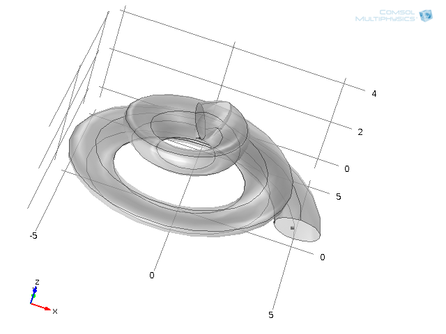

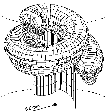

Posted: 1 decade ago 28 feb 2013, 06:05 CET
Hi Ivar
There are two parts that I need help in my model attached.
~ How to taper the cross section along the parametric curve to avoid overlap of material (in current model I increase the radius and height to avoid it which is non-realistic), supposing I know the tapering function
~Is it possible to extrude the workplane in the direction of the curve without any twist. i.e. the corss section is always perpendicular to the base plane(xy-plane). just like the attached image, I think it might be achievable. Otherwise, since I don't know the function of twist. It would be impossible to track the path of a specific point of the workplane which is actually very important for me.
It'd be very nice of you if you can offer some solution/idea. Thank you very much.
Hi Ivar There are two parts that I need help in my model attached. ~ How to taper the cross section along the parametric curve to avoid overlap of material (in current model I increase the radius and height to avoid it which is non-realistic), supposing I know the tapering function ~Is it possible to extrude the workplane in the direction of the curve without any twist. i.e. the corss section is always perpendicular to the base plane(xy-plane). just like the attached image, I think it might be achievable. Otherwise, since I don't know the function of twist. It would be impossible to track the path of a specific point of the workplane which is actually very important for me. It'd be very nice of you if you can offer some solution/idea. Thank you very much.

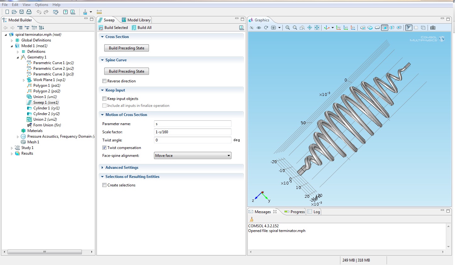

Posted: 1 decade ago 28 giu 2013, 17:59 CEST
I manged to get a tapered helix by putting 1+f(s) (where f(s) is the function of s required) in the scale factor box.
Im not sure what the scale or bounds of 's' are or where you would find these
Hi I manged to get a tapered helix by putting 1+f(s) (where f(s) is the function of s required) in the scale factor box. Im not sure what the scale or bounds of 's' are or where you would find these

Posted: 1 decade ago 8 lug 2013, 15:21 CEST
Hi JC
I dont know how to save as a previous version so here is a screen shot the important bit seems to be the 1 in the scale factor box.
I would still like to know what the bounds on the parameter s are.
Leigh
