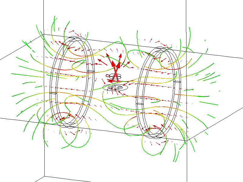

I have modified your model; is this what you are looking for?
Ralf
Sorry for the late reply. and YES! it is what I am looking for (by looking at the .png picture). but somehow, when I opened the mph file, i can't see anything in the graphic. Do you know why?...... and also, what changes you have made to the model to make it looks like this? Can you also explain why? Thanks a lot!
Celia

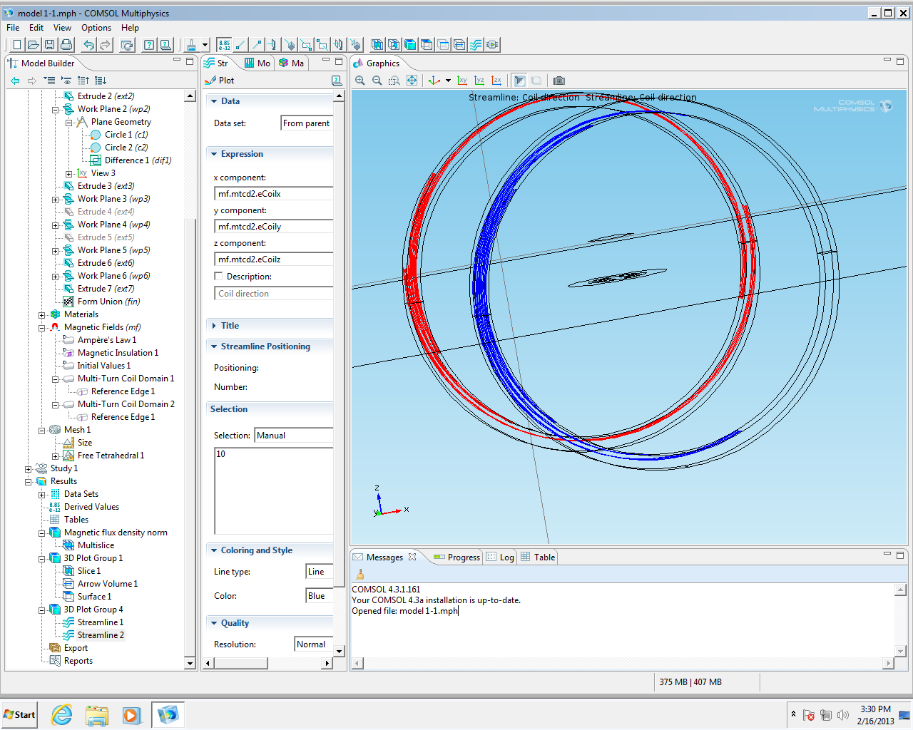

You have to solve it again; the model is clean (deleted mesh and solution to keep the file small).
As Ivar said I use only one MF physic to define all things.
Look at the 3D plotgroup 2 how the definition of streamlines is used (also limits for data range and color...).
Ralf
I resolved the model as you said and now I got the graph you did. it look good! thank you!

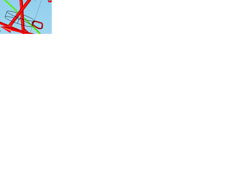

and also, what is the little circular thing attach to the cylinder in the middle? (i have attached a screen shot of it)

Yes, the solution is for all parts; they produce one mag. field.
The little ring is one streamline. Since you have a strong magnet and a little coil current, the field from the magnet is much stronger. My streamlines depend on field strength...
If you increase the currents from 5 to 50A, you will see better images. Play with streamline parameters - you have several options!
The arrows will show you the orientation of the magnet. If you reverse the magnetization, the arrows near the magnet will also be reversed.
It would be better, to use a finer mesh...

The arrow for the orientation of the permanent magnet, can you be more specific? are you talking about the red ones in the field or the one I have attached on my previous reply? Btw, what is the little red thing attached at the side of the permanent magnet?
