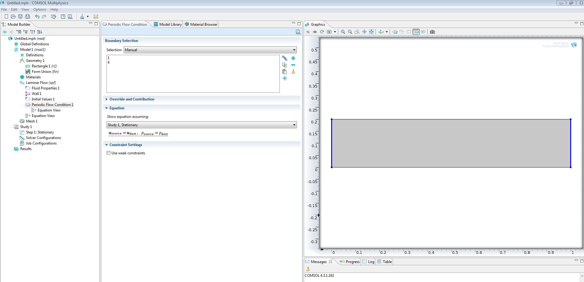

I have a question about the implementation of periodic boundary conditions for fluxes, so that the inflow through one boundary equals the outflow through the other. In comsol 3.5, this condition was 'automatically' implemented when chosing periodic boundary conditions for a dependent variable with Neumann boundary conditions (no flux). Is this the same in the newer versions? (And if not, how can i implement this instead? I am working with the matlab live link, but any hint is highly appreciated) I cannot find any information about this neither in the manuals nor in internet ressources, so if you know the answer, PLEASE let me know, it won't take you ong to write a line, but help me a lot :)

check the "equation" tab of your periodic boundary condition node, for me it's written out fully thereunder (the tab is closed by default, except if you have enabled the default showin of the equations).
I find it useful to regularly check the equations it helps understanding whree you are and what you need to do, possibly help you identify errors in solvers, particularly for multi-physics since all physics do not accept all solver combinations
thx for the reply. I had checked the equation view, but there it says only that the continuity or antiperiodicity condition, respectively, corresponds to var_source=+/- var_destination -- thats clear so far, but does not help me in knowing about any consequences for the flux of var or how to implement inflow=outflow if it is not already included :(
Sabine
in PDE view you have the option for continuity or symmetric, and antisymmetric periodic conditions (4.3a), which means you flip the sign of the flow over the boundaries. This does NOT show up in the equation that remains static, but if you dig into the under-laying COMSOL equations you will see that you have a "-u" instead of "+u"

in SPF I agree, you do not have the symmetry/antisymmetry condition as an option, then use rather inlet and outlet and a coupling variable
