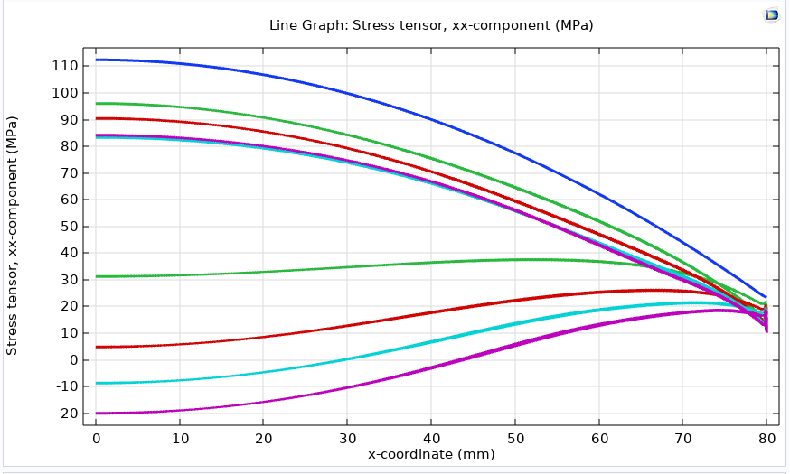

I am currently analyzing a 2D plane stress multilayer beam under the creep effect. I have encountered an issue with the stress distribution on the mid-plane of the first beam layer, where I am obtaining two different values for each position. The attached screenshot illustrates this problem.
Could someone please assist me in resolving this issue?

It will be easier to understand your question if you add legends to the curves. Also, are the graphs along a boundary, or a cut line?
Better even would be to a attach the model, or at least a plot of it.

It will be easier to understand your question if you add legends to the curves. Also, are the graphs along a boundary, or a cut line? Better even would be to a attach the model, or at least a plot of it.
