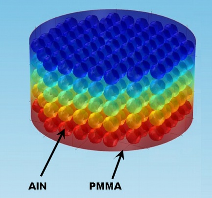

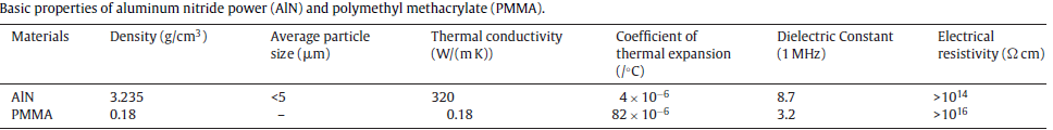

i need to calculate thermal conductivity for various volume fraction of ALN with PMMA. In that paper they mentioned about When the sample is given a heat power,the direction of heat transfer is lower to upper of the cylinder (PMMA).
PMMA they used as cylindrical shape and ALN they specified as sphere. Could you help me how to get the thermal conductivity from input file.(i had attached my input file with this message).

Using comsol , how to define volume fraction value of ALN (1% , 2% of volume fraction of ALN) in PMMA. Previously I had calculated PMMA volume(cylindrical shape (Pi*R^2*h)).Then I take 1% volume of cylinder =volume of the sphere(4/3 *pi*r^3).
In the input file i calculated 1% volume of cylinder= volume of sphere.
Rcy=6.35mm, Hcy=2mm. Rspehere=0.8mm for 1% volume calculation.
Could you help me whether I am following correct procedure for calculating volume fraction value.
If ALN particle size(sphere) should be less then 5um then what are the procedure i need to follow ?

OK but then you have 2 approaches, your method with one lumped sphere might be sovled by a FEM model as you built it,
but if you say you are mixing two materials in a homogenious way then you could probably use a rule of the type
k_eq = (1-pr_aln) * k_pmma + pr_aln * k_aln (for parallel conductances, and the "1/" for serial conductances)
where pr_aln is therelative material volumic ratio of the ALN , but it all depends on what you want to show
