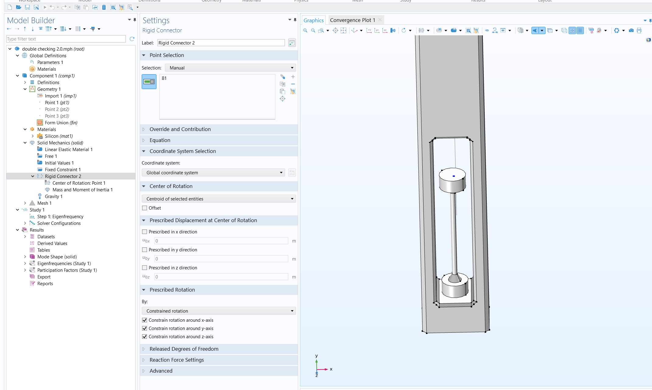

how to input a point mass at the center of the surface
hello i need help trying to set point mass at the center of the surface but it not allowing me to is there another way of doing it?

Please upload your mph file. Unless we can see how you've tried to do it and how you defined the surface, we can't answer your question.

here is the mph. so in the lower flexture i want to put a point mass of 5 kg is using the rigid connector is best choice for this type of problem
