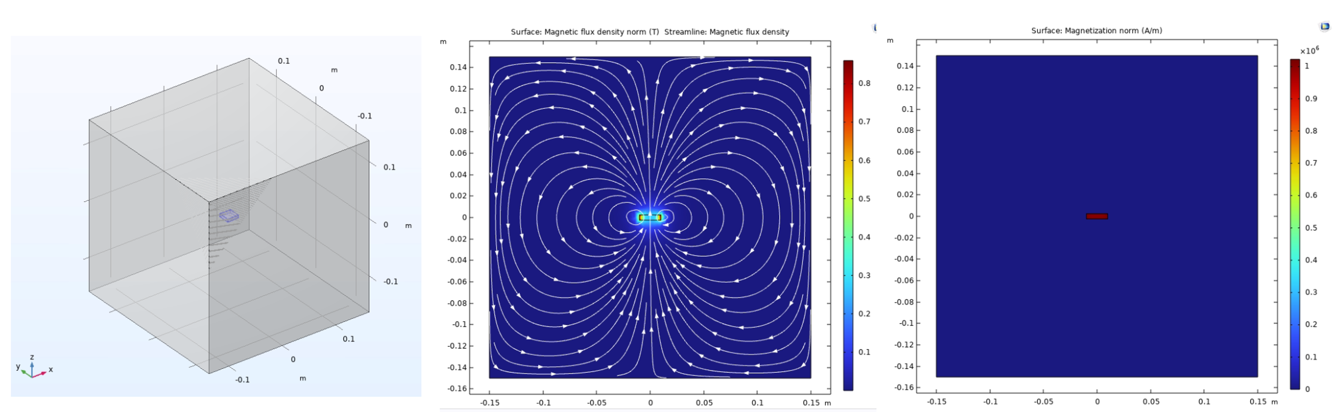

I am trying to model the magnetic field, magnetic flux density, and magnetization of a cuboid shaped neodymium magnet (N42 material), in a magnetostatic situation.
I have made a simple model with a block for the magnet and a block for an air box around it, and am using the magnetic fields, no currents module. The magnet has been set up with a North and South pole.
So far, the magnet produces the expected magnetic field distribution, and shows the expected magnetization inside the magnet of M = Br/mu0 = 1.31T/mu0 = 1e6 A/m (see attached picture).

Fedja,
you would need to use a hysteretic magnetization model, such as Jiles-Atherton in the magnet. JA is available in COMSOL and you need to acquire the respective parameters for the magnet material.
Cheers Edgar
