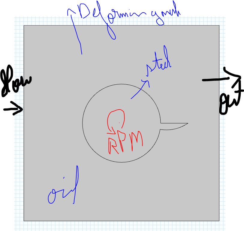

Hi, I would like to ask for help, I need to model a fluid structure interaction in comsol, in which I have a fan in water, and would like to know how to model the fan rotation, without using moment I need to use RPM. The used physics are laminar flow, and multibody dynamics! The picture describing my work is attached to this question.

Hello Rayan,
This blog post addresses your question.
Jeff Hiller
Hello Rayan, [This blog post](https://www.comsol.com/blogs/deformed-mesh-interfaces-rotations-and-linear-translations/) addresses your question. Best regards, Jeff
Magnus Ringh COMSOL Employee
Posted: 2 years ago 6 apr 2023, 12:59 CEST
Hi Rayan,
You can also take a look at the built-in functionality in the Mixer Module, an add-on to COMSOL Multiphysics with the CFD Module: https://www.comsol.com/mixer-module.
Magnus
Hi Rayan, You can also take a look at the built-in functionality in the Mixer Module, an add-on to COMSOL Multiphysics with the CFD Module: . Best regards, Magnus
