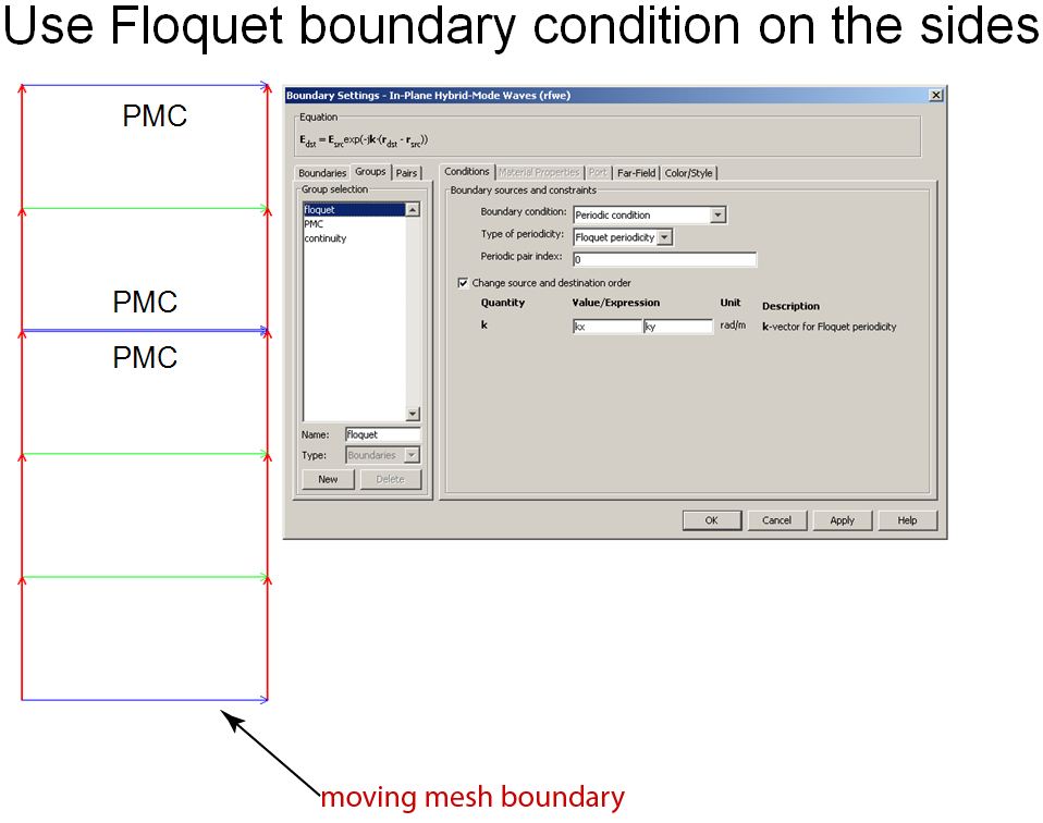

I am trying to use moving mesh (ALE) with FM module and Floquet periodic BC for solving diffraction problem. Comsol gives me all the time the same error:
Error: 6170
Failed to evaluate variable.
- Variable: rdst0x_g1_rfweh
- Geometry: 1
- Boundaries: 9,10
- Expression: Ez-Ez_per0_rfweh*exp(-j*(kperx_rfweh*(rdst0x_g1_rfweh-rsrc0x_g1_rfweh)+kpery_rfweh*(rdst0y_g1_rfweh-rsrc0y_g1_rfweh)))
If I use another BC instead of Floquet periodicity, PEC BC for instance, the model runs without problem. But I really need to include Floquet periodicity, PEC BC works well only for normal incidence in my geometry.
Does anybody know how to combine Floquet periodicity and moving mesh (ALE)?
I attached a sketch of the geometry.
Thanks to anyone in advance!
