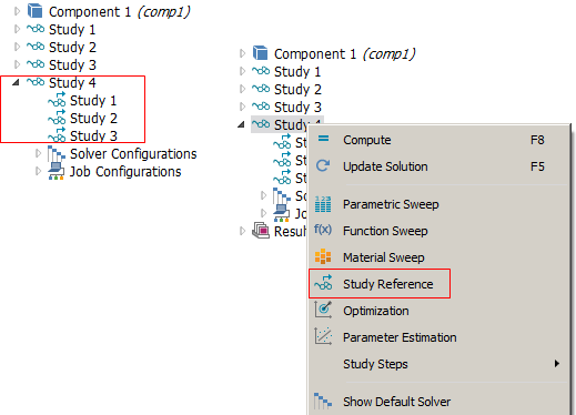

Posted: 9 years ago 9 ago 2016, 12:53 CEST
Dear Yelena,
Did you find the solution for your question?
Dear Yelena, Did you find the solution for your question?
Posted: 9 years ago 9 ago 2016, 13:30 CEST
Yelena,
Yes, you can select several studies into a single separate study using "Study Reference" options, as shown in the attached image.
Sergei
Yelena, Yes, you can select several studies into a single separate study using "Study Reference" options, as shown in the attached image. Regards, Sergei
