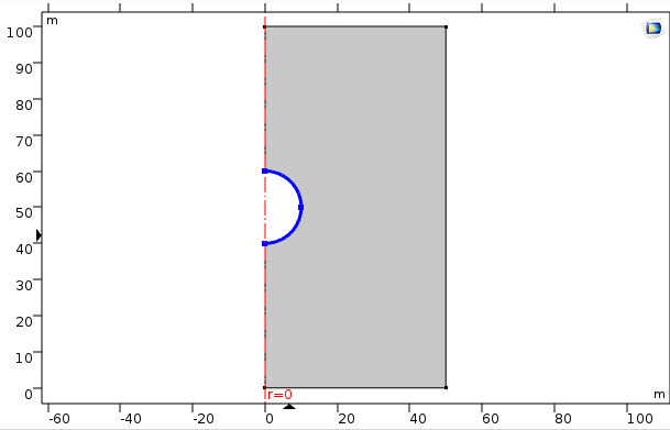

I explain the problem.
I have a solid that it deforms over time under the action of loads (elastic+creep).
The solid is a cylinder with a hole with sphere geometry (initial) in the center. With the passage of time the geometry of the sphere will change and also its volume. The problem I have is that the sphere is not a mesh domain, so I am not able to calculate its volume with a double integral and including 2pir (by clicking the postprocessing box), or creating an expression like this 2pir. I am able to calculate the surface of the contour but not the volume.
I solve the temporal evolution of the volume by including nonlinear geometry in the solver. And as an "approximation" to solve the problem I have included a material with properties of "air" in the hole. But I am concerned that as I make the model more complex, this jump between the properties of the cylinder and those of the artificial domain "air" that I have created could give me problems. I prefer being able to calculate the volume directly.
Somebody could help me? I've been looking at the Forum for days and there's a lot of information about axisymmetric 2D volumes but nothing works. I think the problem is the fact that I have to calculate the volume of a hole or external boundary.
Attached two pics.
Best! AS

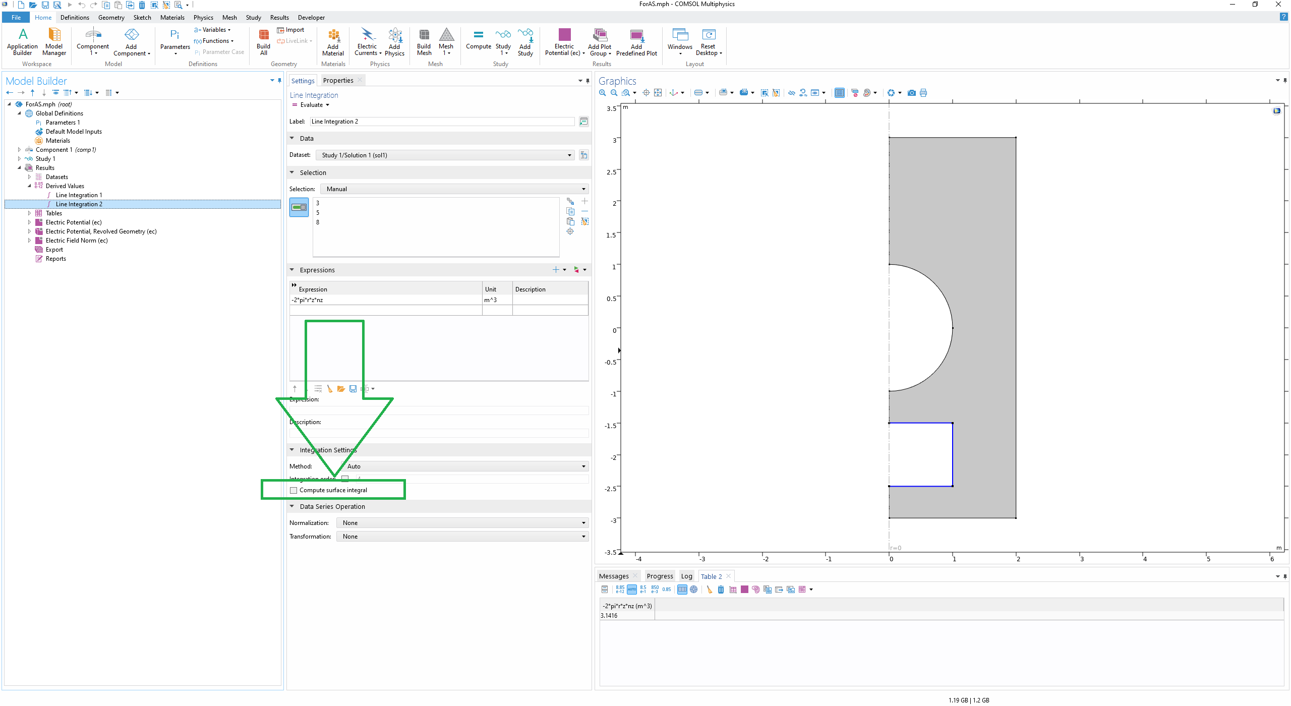

Dear Mr. Koslover,
Thank you very much for your reply.
I have applied this method and another variant that is , where dA would be dr*dz (area differential). However, neither of the two methods gives a correct result for a contrast test with a sphere of 10 m radius.
I think the problem is that the COMSOL simple integral operator calculates the line integral, that is: , where dS is the differential arc length of the boundary, but I would need it to do the integral: where dz is the height differential and I don't know how to do this.
Applying: "Results>Derived values>Line integration" on the boundary shaded in blue of the figure "hole_in_volume_2D_axi" with the "Expression (1)" half the length of the circle is obtained. And if I carry out the same operation, in that same contour but applying the "Expression ()" I obtain the surface of the sphere that encloses the volume that I want to calculate. In the case of a sphere, I could deduce the volume from the surface (as long as the deformation is low). But this does not interest me, I only use the sphere as a test to know that I am doing the calculations correctly, I need the volume to be calculated in a generic way for any type of boundary that generates a hole within the axisymmetric 2D model.
If you can help me I would greatly appreciate it.
Kind Regards, Andres
