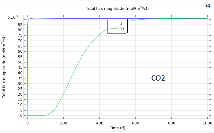

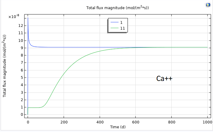

When I run the model I get satisfactory results. **The only problem is, when I check the total fluxes for different species at the inlet I get a non-zero value. In rules as I am injecting only CO2 I should not get any other inflows. **

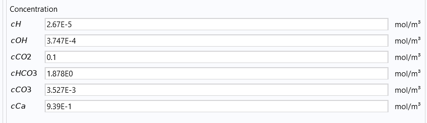

I have attached the initial values and the total fluxes for CO2 and Ca++ at the inlet. ‘Line 1’ is for inlet and ‘Line 11’ is for outlet.

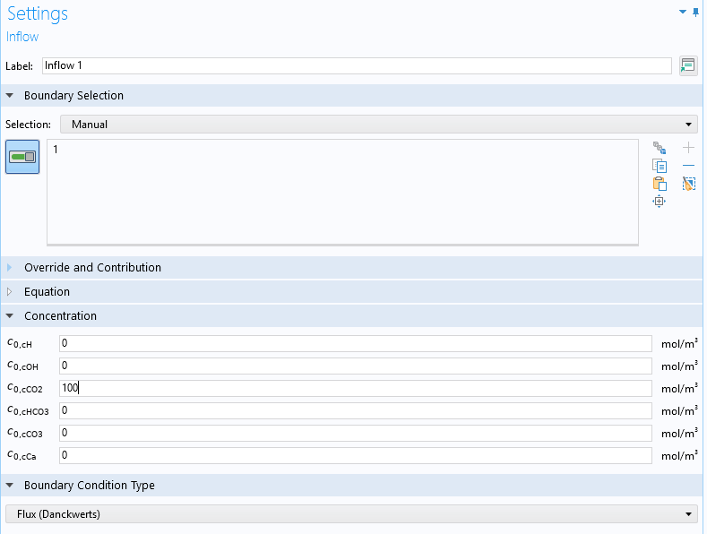

Perhaps you have to explicitly define that the inflow of other species is zero.
Posted: 3 years ago 14 giu 2022, 12:46 CEST
yes the inflow of other species is zero. see the attached photo.
