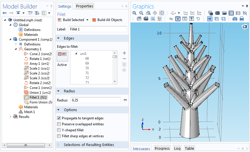

Hello Paul,
Creating trees is an interesting geometric question. With the new Design Module (www.comsol.com/design-module) you do have fillets available in 3D. The attached screenshot will give you some ideas about how you might create such a structure.
With respect to small features getting created during geometry creation, resulting in very small mesh elements: You will find Virtual Operations helpful here, for more details, please see: www.comsol.com/blogs/using-virtual-operations-simplify-geometry/
