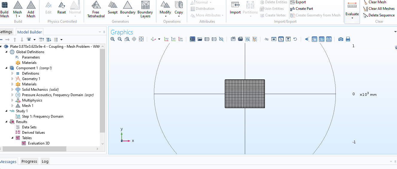

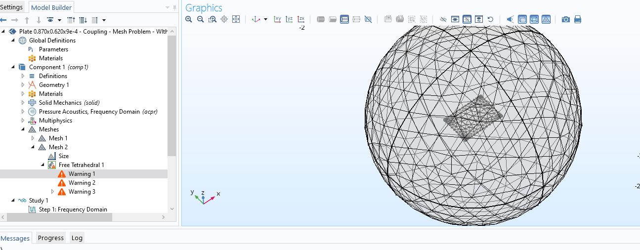

                                                    Hello Magnus, how is it possible? When I set a mapped mesh for the plate and after a the tetrahedral mesh for the sphere the second is overwritten to the first..

                                                    Hello Giada,
First create a mapped mesh on the plate and then a terahedral mesh on the remaining geometry (that is, the sphere surrounding the plate). Don't continue by meshing the entire geometry using tetrahedra.
Magnus
                            Hello Giada,

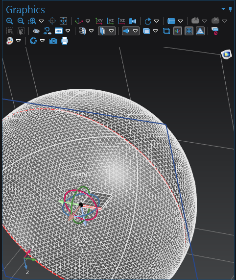

                                Magnus Ringh
                                                                                                                                                    COMSOL Employee
                                                Posted:
                                4 years ago
                                25 gen 2022, 10:35 GMT-5
                                                    Hello Giada,
I see. There is so much functionality to explore!
I used a Clip Plane to interactively look "into" the 3D geometry. It is available in the most recent versions of COMSOL Multiphysics (5.6 and 6.0).
Magnus
                            Hello Giada,
