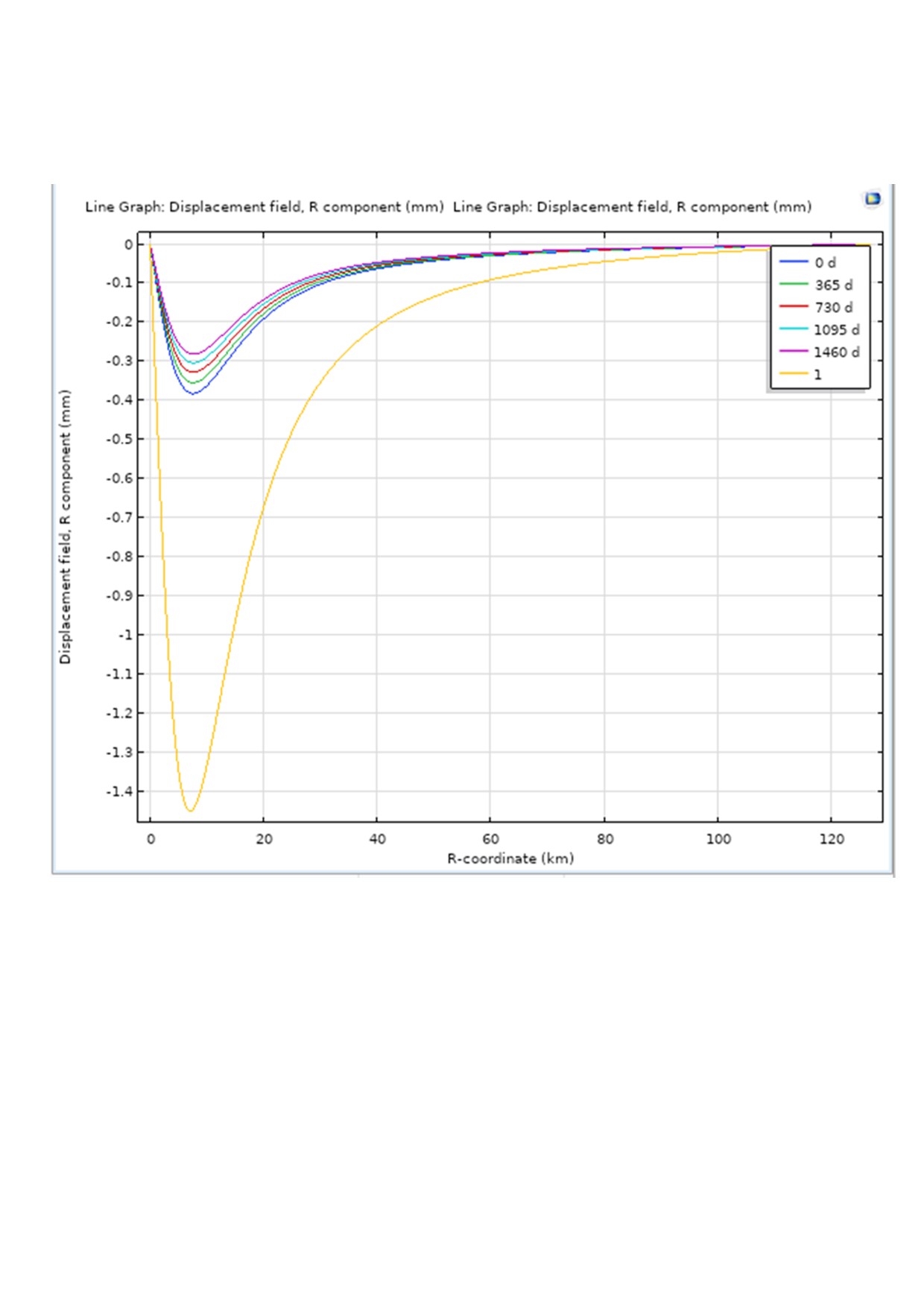

Hi everyone, I was trying to run a model in Structural mechanics by changing one parameter over time. My model has one study divide into two steps: 1) stationary, a boundary load is applied to a boundary of my geometry, 2) time dependent, the boundary load is now set = 0. What I want to achieve is to observe the viscoelastic behaviour of the material involved when a I changed the boundary load from a value to zero over time and set as initial step of the time dependent study the solution from the stationary step. I computed the stationary step and then I change few setting conditions in the time dependent study as it is possible to see in the figure.
When I plot my result I can see two solution solution store (sol2), the stationary solution, and solution sol1 for the time dependent.
I am wondering if is correct how I set up the time dependent setting. I don't quite understand the difference between the solution given by the stationary step (in yellow) and the solution for t=0 for the time dependent (in blue). Should not they be the same?
Also, I was wondering if it is possible to do this just using one time dependent step where I set up an interpolation function, boundary load vs time, for t=0, I assigned a value to the boundary load, and for t=0+ I set the boundary load to zero. Is this something feasible?
