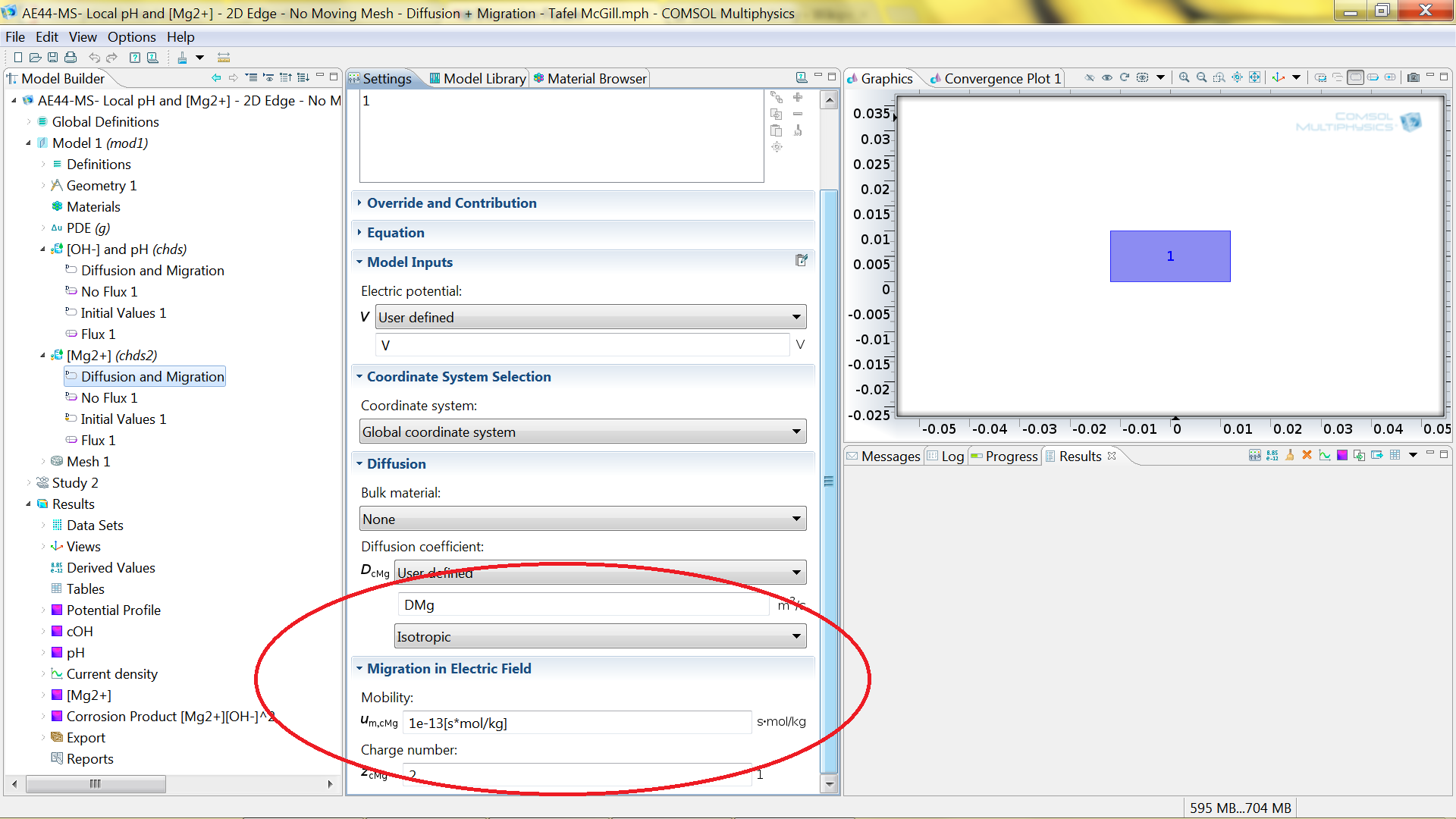

In Nernst Plank equation, we must enter the mobility of one ion for the migration in electric field.
But in Comsol, the unit of the mobility is [S.mol/kg].
In the scientific articles, they use the mobility with unit [m^2/V/s]. [1]
So can Comsol staff explains me how to convert the mobility in science to the mobility in Comsol ?
If anyone was Comsol staff around here, I would have thought it was you. That's because you have "COMSOL" written in parentheses right next to your user name, which would typically indicate that... People answering in the forum are (mostly) regular users. To get an answer from Comsol staff, you would have to (be paying for and) contact Support.
To try to answer your question... Assuming that by "[S.mol/kg]" you meant "[s.mol/kg]", I think the difference between the two definitions is just a factor of the Faraday constant (elementary charge times Avogadro's constant). To be sure, you have to look at the term that describes the migration of ions in the electric field in whichever Comsol module you use (see the documentation) and compare it to the definition used in other literature (like the Wikipedia article).

Let u_i be the mobility with the unit of [s.mol/kg]; and u_e for [m^2/(V.s)].
Their relationships are:
u_e=u_i*F
Let's check the units of the right hand side of above equation.
u_i*F=[s.mol/kg]*[C/mol]
=[s.C/kg]
=[s.C.(m/s^2)/N] , (Newton's Law F=M*a: [N]=[kg]*[m/s^2))
=[C.m/(N.s)]
=[m/((N/C).s)]
=[m/((V/m).s)] , (Definition of electric field: F=Q*E: [N]=[C]*[V/m])
=[m^2/(V.s)]=u_e
