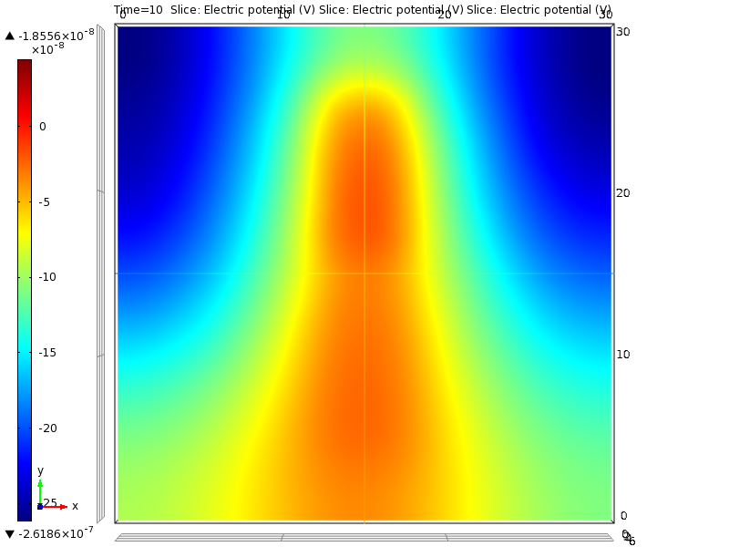

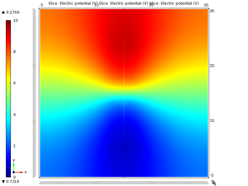

hi ivar
I asked u in other thread about ac field in time dependent . i used ac/dc in electrostatic nd applied 10*sin(2*pi*f*t).
in terminal settings. t varied between 1-10 sec. but i dont know what i did wrong . potential came in negative and field distorted. in DC it looks fine.may be i am doing something basic wrong. I m new to comsol so plz look into this.
hi ivar I asked u in other thread about ac field in time dependent . i used ac/dc in electrostatic nd applied 10*sin(2*pi*f*t). in terminal settings. t varied between 1-10 sec. but i dont know what i did wrong . potential came in negative and field distorted. in DC it looks fine.may be i am doing something basic wrong. I m new to comsol so plz look into this.
Posted: 1 decade ago 28 lug 2012, 21:05 CEST
your DC looks proably reasonable, but the AC is basically "0", no ?
if you use a time series, for 10 seconds or more, what kind of frequency do you have ? if its in the MHz domain, you need to sample (time step) in the sub microsecond level, henceit will calculate for ages perhaps 10E6 times ?
Are you sure its not better to use a harmonic solver (frequency domain) ? and solve for the amplitude, than use a transient solver in time series ?
If you use a time solver, be sure you use a strict or intermediate time stepping, with a time sequence short enough to resolve each frequency oscillation
Hi your DC looks proably reasonable, but the AC is basically "0", no ? if you use a time series, for 10 seconds or more, what kind of frequency do you have ? if its in the MHz domain, you need to sample (time step) in the sub microsecond level, henceit will calculate for ages perhaps 10E6 times ? Are you sure its not better to use a harmonic solver (frequency domain) ? and solve for the amplitude, than use a transient solver in time series ? If you use a time solver, be sure you use a strict or intermediate time stepping, with a time sequence short enough to resolve each frequency oscillation -- Good luck Ivar
