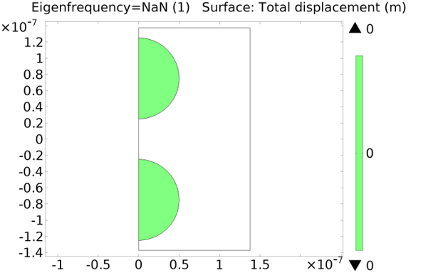

When I did it, the Eigenfrequencies return as NaN. Please see attached.

Well, I tried it and it solved. Those pictures do not help.
