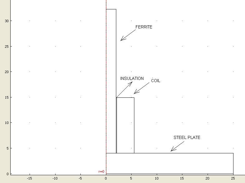

I am currently trying to model an Eddy Current probe, axial symmetry 2D, Quasi-static, time-harmonic analysis, to check the flux magnetic density inside of a steel plate. However, I am having some difficulties. As you can see, in the attached file, the probe has 1 coil with 1000 turns and 1 ferrite core. If someone could help me with this model, I'll be very thankful.

Question 1: Yes, I included an overall enclosing area and inserted the boundary conditions.
Question 2: That is exactly what I'm doing. I have 142 mA in one single wire and the coil area is about 30[mm^2]. Considering 1000 turns, my current density is close to 4.7e6[A/m^2]. Is that ok?
Question 3 and 4: I don't know exactly the magnetic and electrical properties of my steel, but I think it is close to Steel AISI 4340, so I could load the properties from the COMSOL library. For the ferrite I used the Iron properties from the library. These approaches are good?
Now I'll first model the probe (without the plate), just the ferrite and the coil, when I'm sure that my probe is working, I'll start to make the problem more difficult (with the plate). I did some measurements of the magnetic flux with a gaussmeter in a real probe and I found some values around 0.5 mT closer to the probe. I'm trying to reproduce this experimental test with COMSOL but the results are not very similar. Do you think these differents results are because my approaches are not good or might have some construction mistake in my model?
