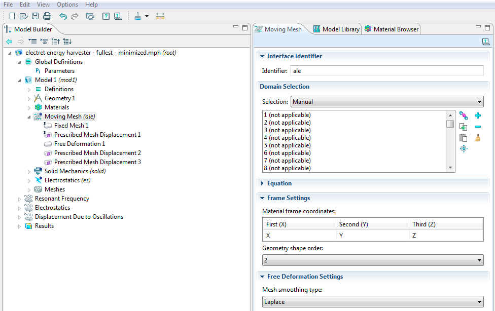

When I set my moving mesh ALE node before the solid mechanics node, all the domains I had chosen in the moving mesh become not applicable. Please see attached screenshot.
Thanks,
[QUOTE] Hi another issue I have been told: set the moveing mesh ALE physics first, before the structural, as node order / precedence has also some importance. Solid and its frames, and ALE do interfer. As clearly stated in the reply above, we need to analyse our models first, in detail: identify clearly the links, see which dependent variables are solved where and identify how to link them. Multiphyiscs, is somewhat more complex than what one could first think, but once used to it, it becomes real fun ;) -- Good luck Ivar [/QUOTE] Hi, When I set my moving mesh ALE node before the solid mechanics node, all the domains I had chosen in the moving mesh become not applicable. Please see attached screenshot. Thanks, Jeff
Posted: 1 decade ago 24 mar 2013, 14:50 GMT-4
that is exactly it, Solid has its own frame system so this overides ALE, ALE is for air (which is no solid) domain that is deformed by the solid deformation (check the model library examples)

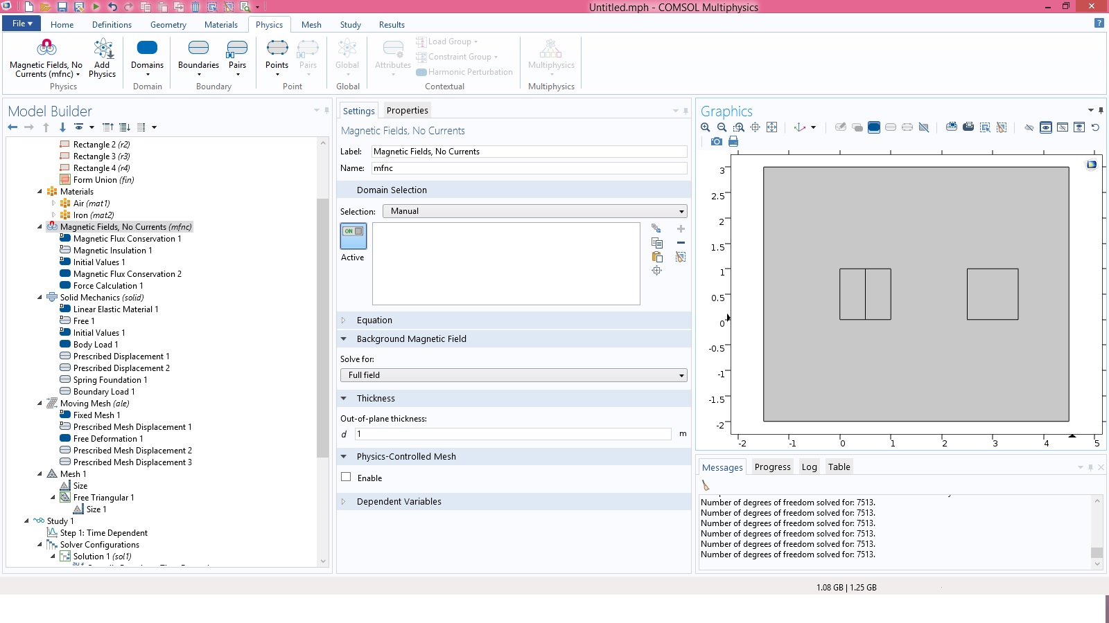

Posted: 10 years ago 23 gen 2016, 16:24 GMT-5
Hello Mr. Yushanov,
I have been trying to do the same with 2D model witth square shapes. I implemented the familiar steps but result is failure. Can you help me to solve this?

Posted: 10 years ago 23 gen 2016, 17:21 GMT-5
At most I can get NaN value :) and no motion in animation.
