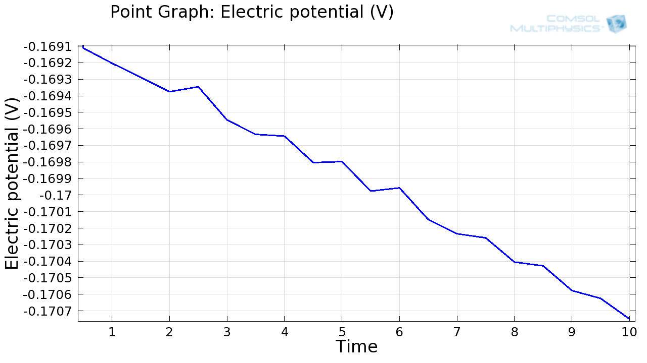

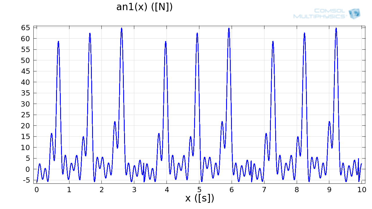

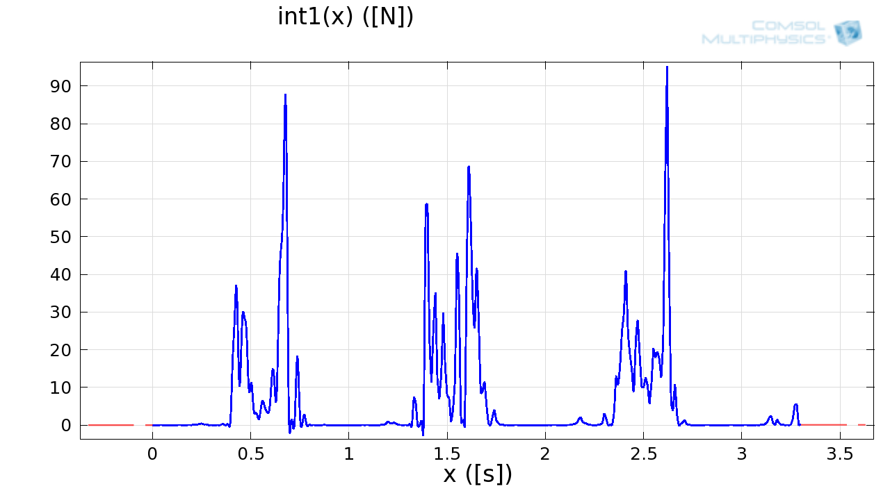

My function is too random. I have created an analytical curve out of it by curve fitting but for my work, I will prefer to use it as it is. I have made the analytical function periodic as you said. I am attaching an image of the analytical as well as raw function that I want to use. I apply these loads as boundary loads (Total force) on the surface of a piezo structure. I call the function as -an1(x) or -int1(x) (- sign as I want the force to be vertically downwards). But, as you can see in the attached point graph for a point on the surface (50,15,10) the output voltage is decreasing. Is it a mistake in the function calling? Also is there any way by which I can simultaneously see the amount of force being applied with the output voltage? (Currently I set the results while plotting option to voltage and I can see the voltage generated for each time step). Also how do I call the modulo function for this case. IF you can suggest me with a example for modulo function use in this case, it would be really helpful.

Posted: 1 decade ago 2 mag 2012, 23:15 CEST
if you call your function with a myfunc(t[1/s]) then the numerical value of time, in seconds, should be well understood by COMSOL.
However with such random signals, have you set the solver node to "strict" time stepping (and not the default "automatic"), with a small predefined tme step to solve the signal details ?
Check also your log file, if you have several lines with" -out" without any solver steps, its COMSOL interpolating and probably skipping over the spikes of your signal
Hi if you call your function with a myfunc(t[1/s]) then the numerical value of time, in seconds, should be well understood by COMSOL. However with such random signals, have you set the solver node to "strict" time stepping (and not the default "automatic"), with a small predefined tme step to solve the signal details ? Check also your log file, if you have several lines with" -out" without any solver steps, its COMSOL interpolating and probably skipping over the spikes of your signal -- Good luck Ivar
