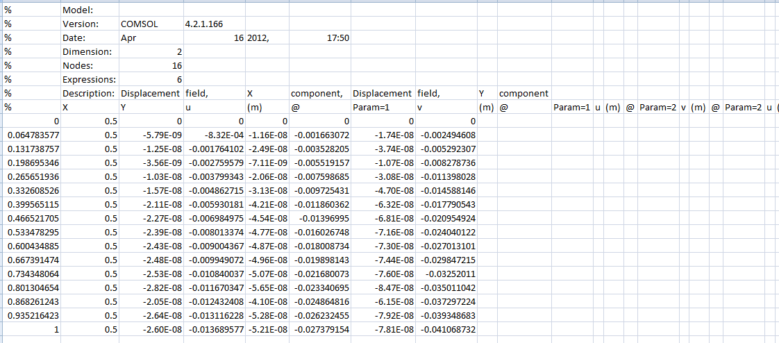

I'm looking for a way to export in an automatic way some results in a text file, in the same way that the 3.5a version does. Back then all you'd have to do was to specify the variables you wanted to export and the output file. I can't find that (very simple) option in the versions 4 (in my cas 4.2a). In the Job configuration menu there is Export to file, but I can't manage to make it work. I couldn't find any (valuable) hint in the doc.

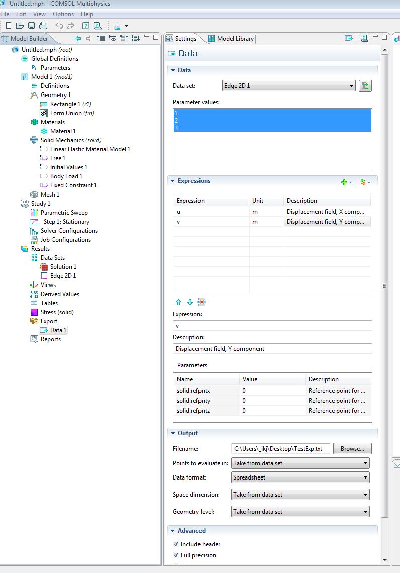

try the following:
Data Set edge or surface or cut line, plane ...
Right Click export
Define the variable(s), the interpolation, the format, file name ...
Export F5
Hi try the following: Data Set edge or surface or cut line, plane ... Right Click export Define the variable(s), the interpolation, the format, file name ... Export F5 -- Good luck Ivar

Hi Ivar,
I ran your file (changed the export data destination) but it did not export the data after simulation was done automatically. I had to press 'Export' manually to export the data file. How can I have the file after simulations exported?

Hamid,
I have done this using the App Builder capability in the newer releases.
Write a method or have a button event that performs the Export command automatically.
For example, use "Record a New Method" to record the method text for Exporting tabular data or whatever data you'd like to export.
Your method code may end up looking something like this:
model.result().export().create("tbl1", "Table");
with(model.result().export("tbl1"));
set("filename", "C:PATH\FILENAME.txt");
endwith();
model.result().export("tbl1").run();
Once you learn how the methods work it really is quite straightforward to be able to automatically do a lot of repeated, script-type steps that you'd otherwise have to do manually.
