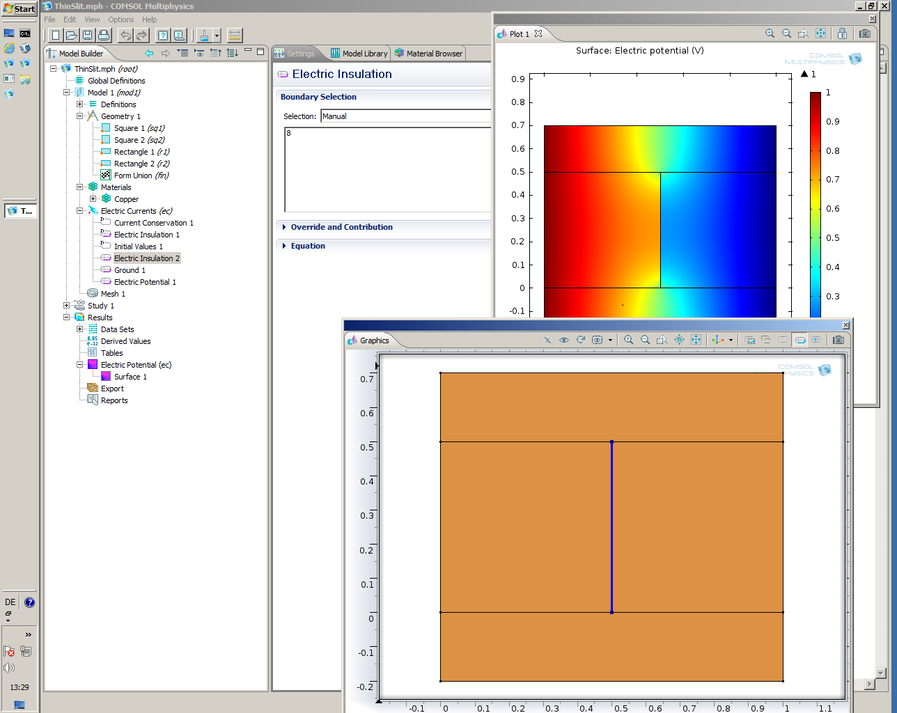

                                                    Sadly it looks like the update is going to be a next to impossible task. Would it be possible to take a screenshot of the model builder tree for me to see the structure of how you've created yours?
Thank you so much.
Thank you so much.
                                                Posted:
                                1 decade ago
                                3 apr 2012, 07:43 GMT-4
Here is the screenshot. I assembled those 4 domains, all are copper. This way I could set the internal boundary to insulation. Left and right boundary are set to 1V potential and ground. The other internal boundaries are continuous as default.
Cheers
Edgar
Cheers
Edgar

                                                    Okay great, thank you!
This will be a good starting point though eventually I'd like to model some random cracking and cavitation in my material so I don't think I'd be able to tessellate very large numbers of shapes in this manner.
I'm currently experimenting with using very large aspect ratio rectangles (100:1) and setting an electrical insulation boundary condition on them. It seems to be functioning though I had hoped that the suggested update in 4.0a would make this easier. I envisage that with the small size and large number of 'cracks' (rectangles) I will eventually run into meshing problems with my rectangle method.
