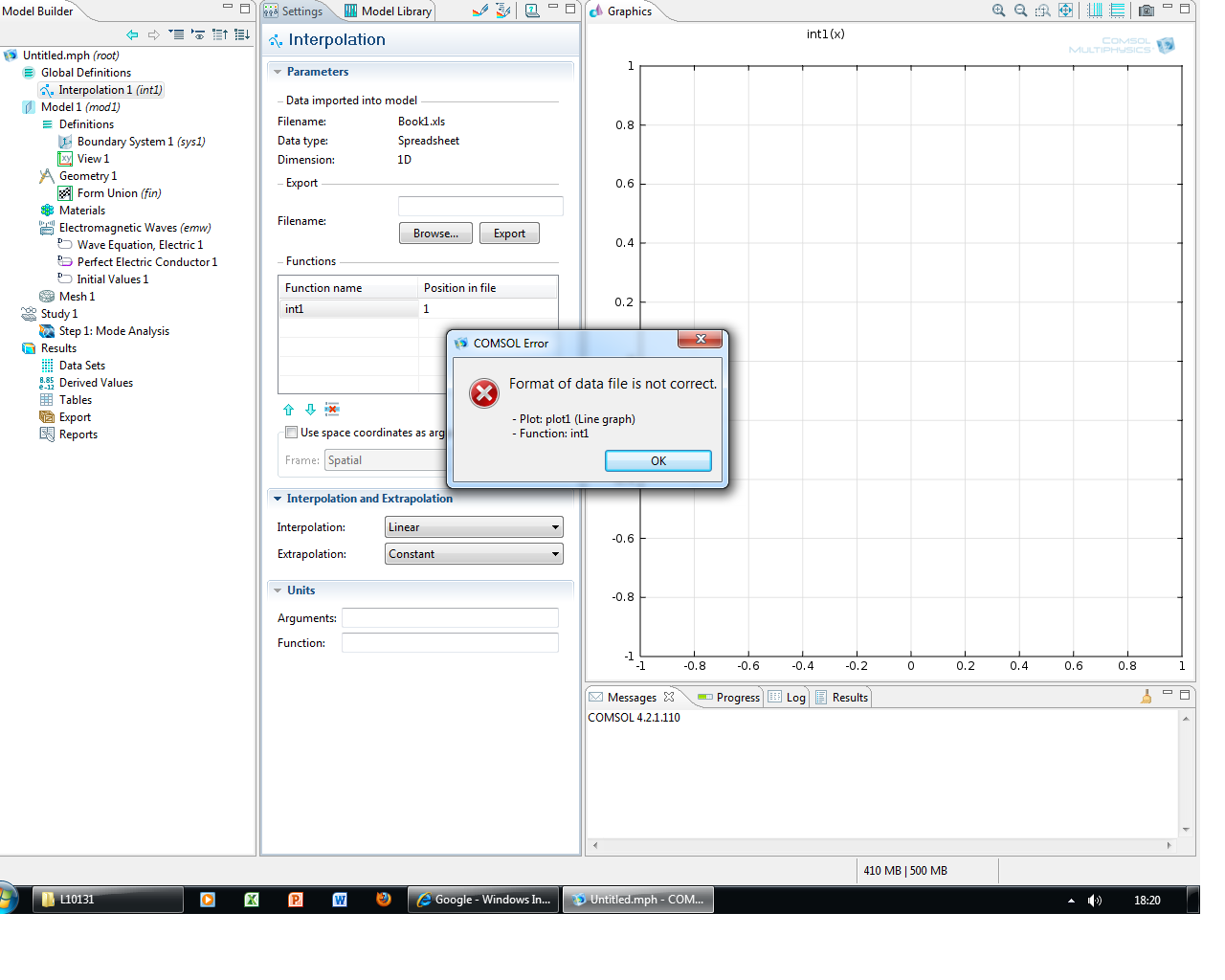

I want to plot my experimental data (refractive index of material) in comsol and use this function as property of structure. I am using excel file. After importing, it gives me an error that "Format of data is not correct". Please find the attachted copies of data and error image. Please help me to resolve this issue.

save 2 columns to .txt file and use it instead of .xls
Posted: 1 decade ago 17 mar 2012, 10:37 GMT-4
In Excel, select Save as from the File menu and save your spreadsheet as a CSV (Comma Delimited) file. It will ask you
about some compatibility issues (i.e. it could not save multiple sheets). After this, you can import this CSV file in Comsol.
I have also included the CSV converted file.
