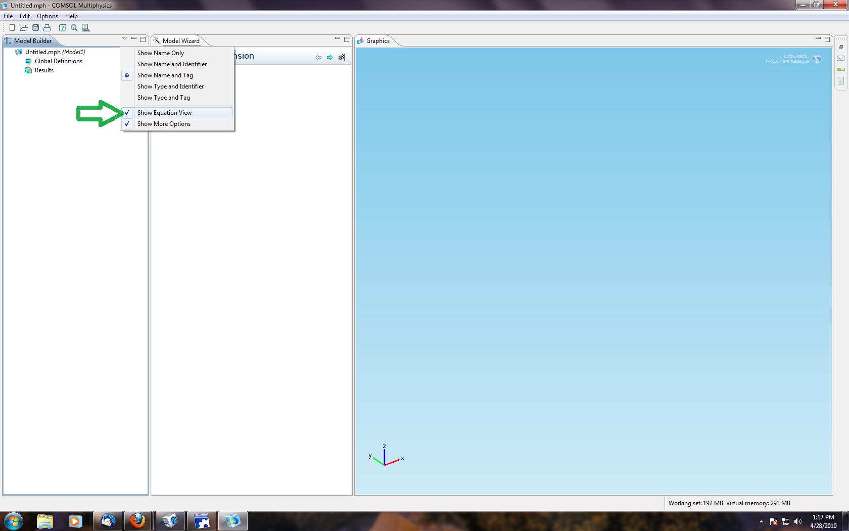

p.s. Is anyone else on COMSOL 4.0 having trouble seeing the equations?? Yes, I've clicked on show equations, and I click on "Update Equation View". But the only things to ever show up are the constraints. Once, on a k-e, I got loads of equations to show up on a boundary condition, but this is a rare event.

for the equation, the "upper level" is not yet implemented, but the "lower level" is there see file
