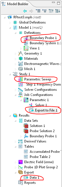

Now I am trying to move to COMSOL 4.2a and to do the same parametric sweep with variable export into one txt file on each iteration step. I tried the following procedure:

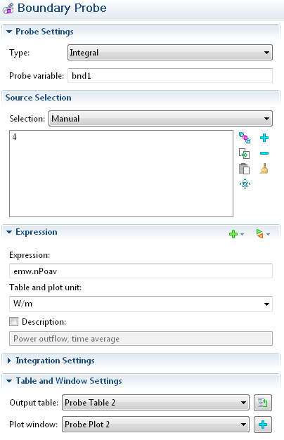

1) Add a boundary probe of integral type. This probe value I want to export in to the log file.

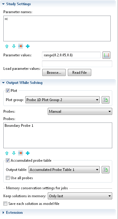

2) Add a parametric sweep node under the study 1 node.

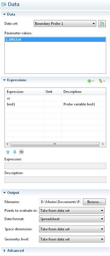

3) Add a data node under Export node and set the file name.

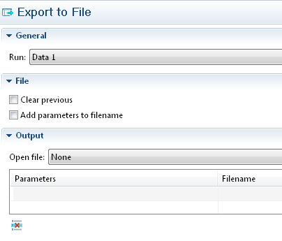

4) Add a Export to file node under Study->Job configurations->Parametereic and select Data 1 from Run list.
5) Deselect Clear previous and Add parameters to filename checkboxes.
And I am getting the effort massage: “Error in sweep: could not overwrite existing file.”
