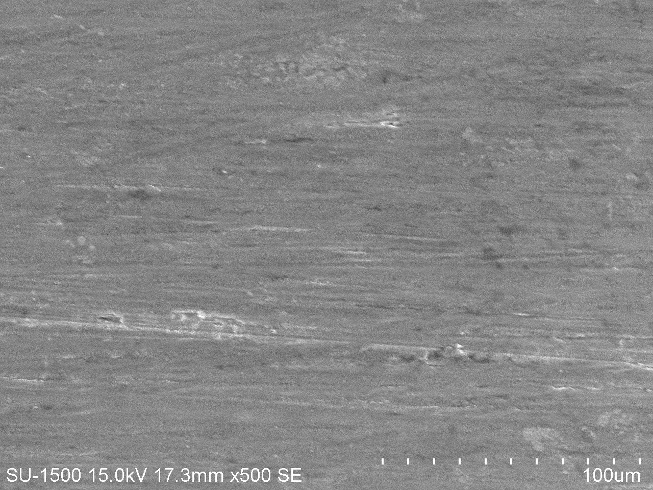

Hi I have SEM report which is in jpg format these image has to be imported to the comsol so that i have to define material . it is a composite of two material, i am finding thermal residual stress on it,,please tell me how to proceed. and how i can change the temparature parameter.
Posted: 1 decade ago 21 apr 2015, 06:20 GMT-4

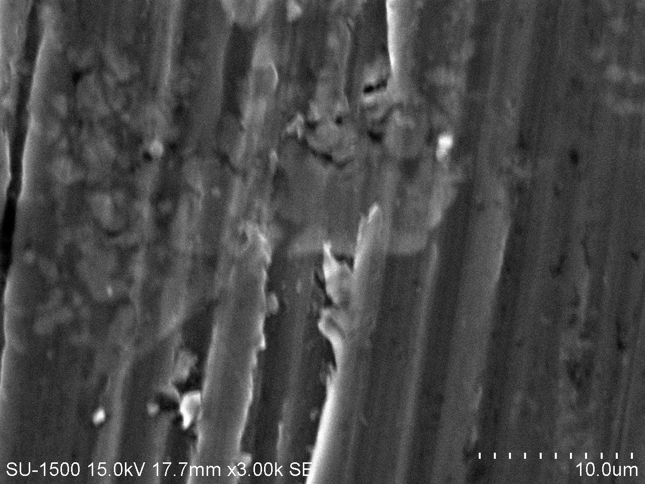

files are attaached
Hi I have SEM report which is in jpg format these image has to be imported to the comsol so that i have to define material . it is a composite of two material, i am finding thermal residual stress on it,,please tell me how to proceed. and how i can change the temparature parameter. files are attaached
Posted: 1 decade ago 21 apr 2015, 07:51 GMT-4
You can define an Image function and use the value from it when setting up your physics.
Posted: 1 decade ago 21 apr 2015, 10:50 GMT-4
On the subject of JPEG: it's dangerous because JPEG contains compression artifacts: anomalous oscillations in intensity near edges. PNG is better. But you can trivially convert between image types with a suitable software, for example "ImageMagick" tools, in particular "convert", does it quickly and effectively. Then you don't need to worry any more about JPEG load-save cycles causing further degradation to your data.
I'm very interested in this subject myself. In computer graphics, for example POV-Ray, there's the notion of a "bump map" which perturbs surfaces along their normal using an image. In POV-Ray it's done using a linear perturbation applied to the scattering direction of light. But it could also be applied to a displacement field. The challenge is mapping a 2-dimensional image to a 3-dimensional surface. For example maps between a 2-dimensional map and the near-spherical earth surface is a nontrivial topic.
Anyway, I'd just convert the images to PNG.
On the subject of JPEG: it's dangerous because JPEG contains compression artifacts: anomalous oscillations in intensity near edges. PNG is better. But you can trivially convert between image types with a suitable software, for example "ImageMagick" tools, in particular "convert", does it quickly and effectively. Then you don't need to worry any more about JPEG load-save cycles causing further degradation to your data. I'm very interested in this subject myself. In computer graphics, for example POV-Ray, there's the notion of a "bump map" which perturbs surfaces along their normal using an image. In POV-Ray it's done using a linear perturbation applied to the scattering direction of light. But it could also be applied to a displacement field. The challenge is mapping a 2-dimensional image to a 3-dimensional surface. For example maps between a 2-dimensional map and the near-spherical earth surface is a nontrivial topic. Anyway, I'd just convert the images to PNG.
Posted: 1 decade ago 21 apr 2015, 11:37 GMT-4
Hello Devendrakumar,
there are two ways to work with images in COMSOL.
The first one is to using image function as Gunnar said. It is described in previous answers.
The second one needs Matlab LiveLink. If you do have that module, check how to use the function "mphimage2geom' in the user guide. The function can convert your image into geometry. It supports quite some image formats. So then you can assign a lot of different properties to your geometry, which is not possible with the first method. There is example how to use the function in the user guide. Especially in the end when you want to calculate something, for example boundary flux, it is possible with this method, but not the first one.
To your specific question, I am very bad in thermal dynamics. Can't really give any tip for your specific question. Sorry for that. Hope this will somehow help you a little bit.
