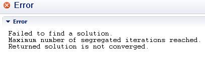

"maximum number of segregated iterations reached", soln not converged
Can someone give me a tip on this.
I have an axisymmetric model that runs fine on 3.5a (attached), no issues.
However, when I re-create this same model in 4.2 (as best I can re-create it, with a contact pair), there is a problem getting it to run for the same level of prescribed z-displacement of the "pin".
The 3.5a model allows the pin to be displaced downward (-ve z) by -0.15 mm, and the model runs fine. There is a contact pair along the interface of the pin and the medium. But in 4.2, I can only get a solution for pin displacement of up to about -0.01 mm in the z-direction. Beyond that value of -0.01mm, I get the attached error message about "maximum number of segregated iterations reached". I used default solvers etc. in 3.5a -- nothing special. Is there some adjustment I should be making to the solvers in 4.2 to get this to run?

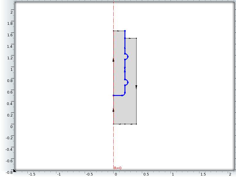

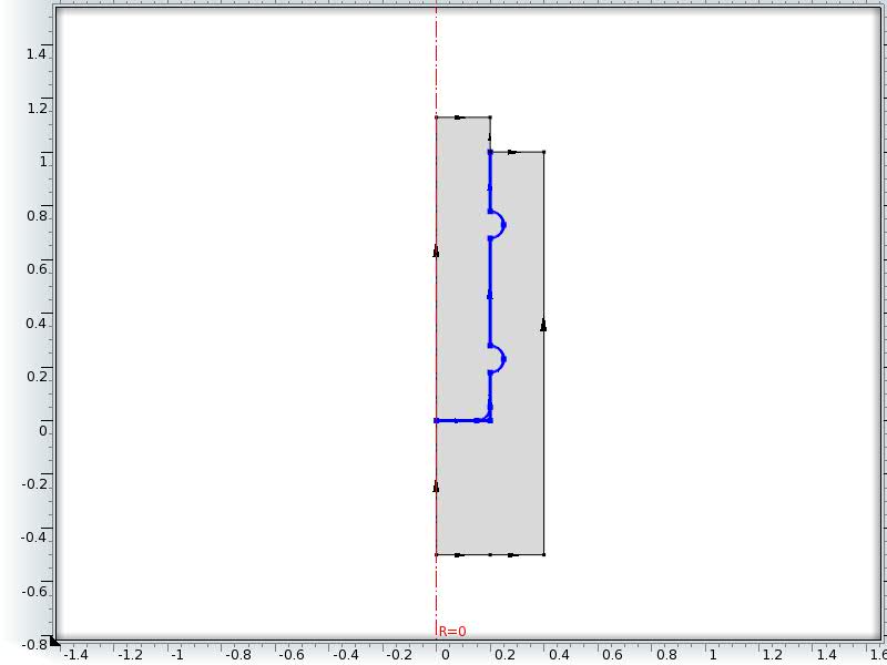

If you look at the two attached images, one shows a contact pair along the interface only, and the other shows a contact pair that extends above when the "pin" exits out of the surrounding material. I'm not sure why my assembly step in 4.2 created the latter type of contact pair, but that seems to be the problem. I say that because when I used the geometry and contact pair as created in Comsol 3.5a (first image attached), the model ran OK in 4.2 -- although only with a fully coupled solver, not the segregated solver. (This 4.2 solution agreed with what I had found in Comsol 3.5a previously.)
In any case, thanks for the tips. I learned a lot by looking thru a lot of the discussion pages. For example, along the way I tried various other "solutions" to this issue, including parametric sweeps -- external as well as continuation sweeps. But these only worked for small displacements of the pin into the surrounding material.
